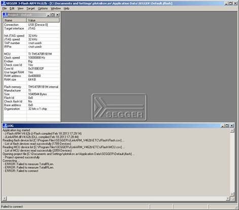

    J-link log
    Help please.

  • SEGGER J-Link Commander V4.62b ('?' for help)
    Compiled Feb 18 2013 17:29:05
    DLL version V4.62b, compiled Feb 18 2013 17:28:44
    Firmware: J-Link ARM V8 compiled Nov 14 2012 22:34:52
    Hardware: V8.00
    S/N: 158005054
    OEM: IAR
    VTarget = 3.254V
    Info: TotalIRLen = ?, IRPrint = 0x..000000000000000000000000
    WARNING: At least one of the connected devices is not JTAG compliant (IEEE Std 1
    149.1, 7.1.1.d, IR-cells). (NumDevices = 1, NumBitsSet = 0)
    ****** Error: Failed to measure TotalIRLen.
