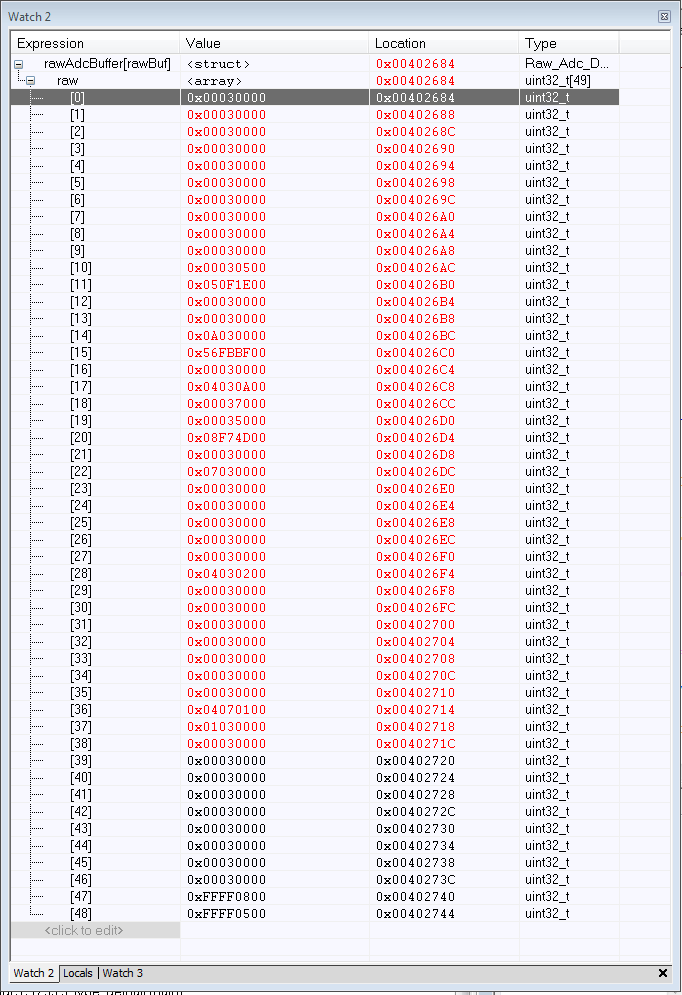

I have a SPI-DMA setup on TMS470R1B1M to fetch data from ADC (ADS1278). This is a 24bit ADC and there are 8 channels. So we read 24 bytes on every ADC cycle. It reads good data but once in a while on power up it starts reading bad values. I have a constant voltage fed to ADC channels. When it reads the bad values, the values jump all over the place. After some debugging I realized that the first byte is some bad value but then the rest of the data corresponds to the good data bytes, but now everything is offset by 1 byte in the array due to the first bad data byte. Also the last byte is lost. I verified that the ADC is sending good values as I gather them on scope. I see that it is sending good packets over SPI. My conclusion is that the DMA is the culprit which somehow does not increment the destination address properly.
Any idea what could be going wrong. I tried to halt the DMA (which should reset the internal regs, but this did not help.

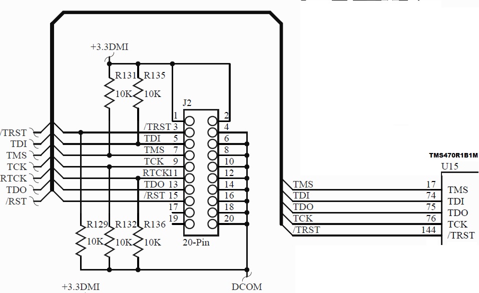

  • Pinakin,
    Could you share the schematic connections from ADC to R1B1M?
    Also, what is order of execution of above setups?
    You can reference the SPI DMA examples here. www.ti.com/.../toolssoftware
    It is in the "SM470R1B1M-HT CAN SPI Driver" After installing, you can reference files in \examples\SPI\Src and in doc directory.
    There are specific comments related to the order in which spi and dma is enabled.
    Wade
  • Wade,
    Here is the snapshot of the schematics SM470R1B1M___ADC1278_schematic.pdf
    Here is how the ADC setup works:
    The ADC DRDY triggers an interrupt when the ADC conversion is complete - indicating that the data can now be fetched by controller. This will setup DMA to perform the ADC data fetch over SPI (DMA setup is shown in my first message above). The DMA will fetch the data and on completion will trigger another interrupt indicating the other modules in firmware that the ADC data is ready for use.
    I have looked at the example (you specified) before. Do you see anything incorrect with my code? Let me know if you have any suggestions for the code.
    Thank you,
    Pinakin

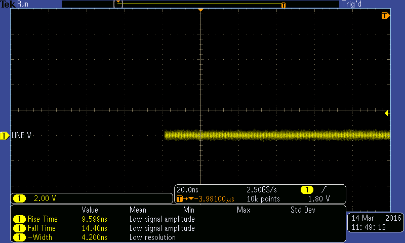

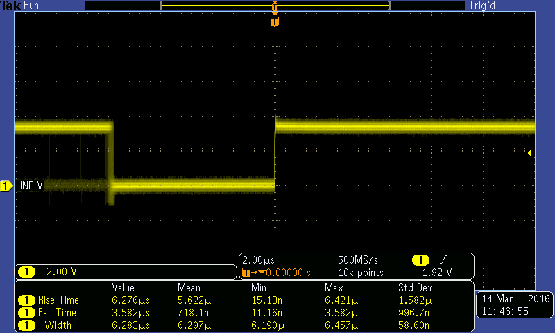

  • Anthony,
    Also I verified DRDY and it looks good. Here is a snapshot of the scope. The top blue waveform (sorry the scope colors are not greatly visible) is DRDY. The yellow indicates DRDY triggered ISR which sets up DMA and does some buffering related stuff. The purple wave indicates end of DMA fetching.
    Pinakin
  • Hi Pinakin,
    The waveforms look almost 'too good' but I don't know what the timescale is either.
    What we need to see is a zoomed in view of the rising edge on the blue waveform.
    Would like to know if the risetime is 1ns, 10ns, 100ns, ... for example.

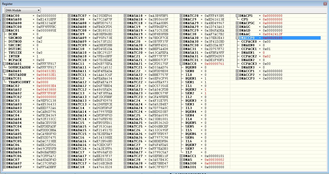

    Regarding the hex values - please with a debugger attached run to the code that writes the control values into the DMA RAM.
    Then just tell us exactly what values are being written. If you have to, you can open a register view and step through the code that does the write, you'll see something like str rx, [ry + #offset] or something and rx, ry will be registers.
    The value to be written will be the contents of the register 'rx' in that case.

    Here is the screenshot of the registers.
    I dont see any values incorrectly displayed here. Also if there is an issue with this then I should never be getting good values, right?
    I captured the DRDY pulse. Here are the screenshots with the rise/fall timings. Please refer to the zoomed images for accuracy.
    I would say fall time is ~ 15 ns and rise time is ~ 9.6 ns.
    Pinakin
  • Hi Pinakin,
    Ok then for now I would say look elsewhere. I don't completely understand the DMA control packet (haven't decoded it) but if it's working most of the time and if you see what you expect in the register window that's good enough. Unlikely this is the issue anyway.
    The rise/fall times look ok too. 10-15ns is on the slower side of what I'd like to see but I think the interrupt line is sampled by the internal clock and so it should be fine with a 10-15ns edge.

  • Pinakin,
    I looked at your JTAG schematic, and it looks ok.
    I think Anthony is on to something with emulator connected and interfering with processor normal operation.
    Wade

    The uint32 values collected from SPI via DMA are as follows:
    From this it seems like the Rx Ovr and Int Flg bits are set in SPIBUF. Is my test code correct? Let me know if there is anything missing.
    Pinakin

    Pinakin Potdar said:
    Last time Anthony told me that he suspects that there was an issue that TI fixed for another customer
    Do you mean
    "Yes I'm wondering now if some memory refresh (reading the peripheral registers while debugging) is clearing a status bit or something to that effect. I thought we had that taken care of in hardware w. the use of the SUSPEND signal on the bus to distinguish CPU accesses from emulator accesses but it's been too long."
    If so no - that's not an issue fixed for a customer - that's how we designed the IP to look at the signal indicating the CPU is halted and disable the read-side effects if the bus access comes along with that signal because it would mean that the bus access is originating from the emulator reading memory during suspend, not from the processor reading code.    Not a bug fix ... by design.    But like I said it's been a while and as time has gone on how to do this correctly has gotten more complicated..
    Looking at your last post prior to these - you had shown that there is an RX OVERRUN error occurring, right  (I didn't check the bit fields in the buffer memory screenshot but just going by your statement and assume you decoded the error flag in the correct bit location..)
    So if that's the case then it points to a problem.   Either you're not keeping up with the reads,  or the reads are not happening at all.   Maybe they are pointing at the wrong address.  Or maybe they are not getting triggered.   But that's the thread to start pulling on.
