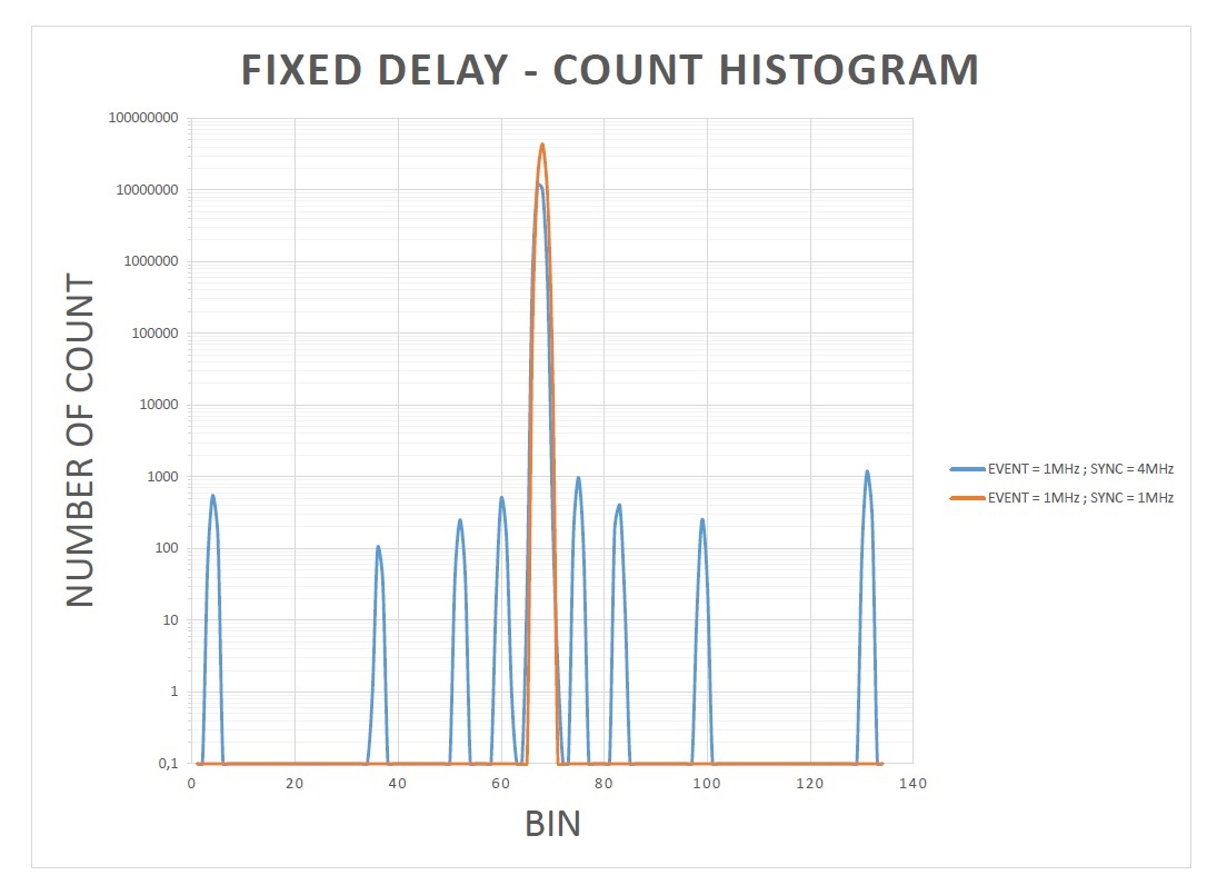

We have been working on a board for time measurement application for the past two years using your THS788 TMU, and we discovered this week that is was operating in a very weird way when using a higher clock rate for the SYNC input.
Here is the situation :
- We are using it in a SYNC-SYNC-SYNC-EVENT processing way, which means many sync period can have no event pulses.
- The chip runs perfectly using a 1MHz SYNC clock and a 1 MHz EVENT input rate using the oboard pulse generator, with a 8ps sigma as promised.
- When using the exact same event input (1 MHz), but a reference clock at 4 MHz, some quantification error start to occur generating really weird histograms. Some smaller peaks appear at (Main peak + 8/16/32 bins). I have attached a picture of this histogram. I have used a logY axis to show more clearly the problem.
I cannot understand why this happens, and it becomes worst as the frequency of the sync pulse increases.
Since this system is supposed to work at a 80MHz SYNC rate, it is impossible to make this project work without understanding what is happening.

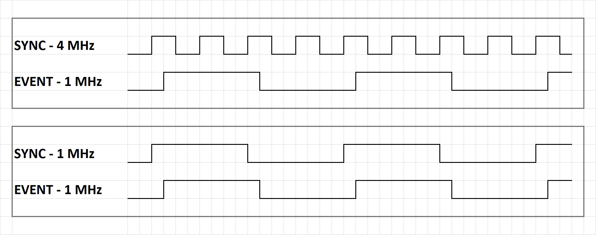

    Can you explain what your BIN values represent (are these timestamp values)? What is the timing of events and sync at the device in both cases? Can you provide a timing diagram?

  • Hi Wade,
    -Yes the BIN in the diagram is the timestamp value (13.02 ps per bin)
    - I am aware of the negative timestamps. At 4 MHz, it happens around 25% of the time. But this doesn't explain why the binary pattern appears at  Peak + 8 bin/16 bin/32 bin. We correct the negative timestamp in normal operation, but I excluded the negative on the presented drawing.
    -Attached is a timing diagram. The delay between SYNC and EVENT is approx 1ns, hence the peak at bin 70 (911ps).

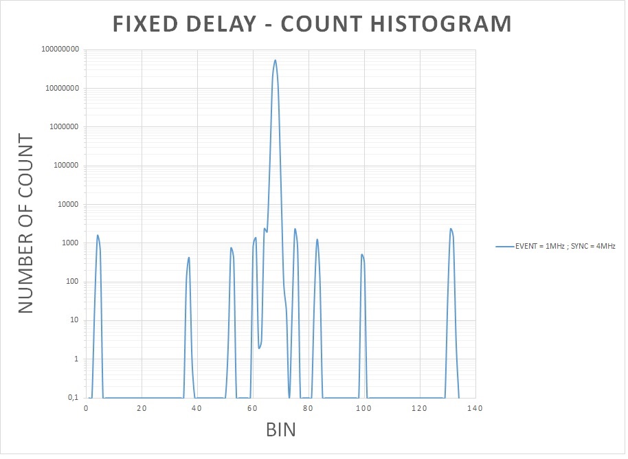

    Can you tell me more about the devices exhibiting this bit error? Because the problem really seams to be linked to a single bit error (which would explain the binary pattern the peaks at +- 8 bin/16 bin/32 bin.
  • I would be interested to see how the other channels compare.
    This does not appear to be related to the BER issue that I mentioned. We have only seen it impact single bits and results tend to indicate a stuck bit in the FIFO from the counter. So there is a pattern to the data in that it will only show up at modulus 16 events (a particular FIFO address). We have only seen this impact a single bit. The histogram appears represent errors on several bits.

  • Other channels behave in the exact same way....
    I have verified if the error could be in the FPGA deserialyzer, but the error is not linked to any bit error. It sometimes impacts several subsequent bits, which tells me the error occurs before the EVENT minus SYNC calculation... (the +-8/+-16/+-32/+-64 error happens before the calculation, which means inside the TMU).
    Are you planning on finding a way to test this feature to determine if you have the same results? Would you be able to get simulation results from the ASIC designers?
  • The error could be introduced from events, or from sync channels.
    All channels reference same sync, so results would be similar amongst all channels if the lsb's of the sync were getting corrupted.
    From the histogram, it appears that data can be off by +/- the lowest 6 LSBs. These are values generated by each channel (and sync) interpolator. I suspect that it is related to the sync's value due to if affecting all channels similarly and its dependence on sync update rate.
