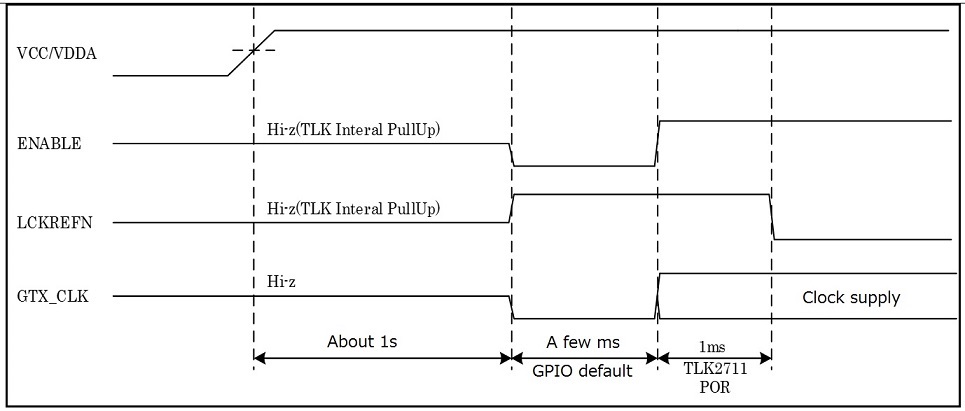

2. Question about the timing between VCC/VDDA and GTX_CLK during POR,
Should we supply GTX_CLK before VCC/VDDA reaches 2.375V?
3. Is there any problem about the attached POR sequence for appropriate operation?

    1) yes 1ms is sufficient to complete the reset. (your plot did not include LOOPEN. It should be similar to LCKREFN)
    2) Sequence is not important. What is important, is that all the conditions for POR are met for 1ms.

  • Hi, Wade-san
    Thank you for your comment.
    Regarding my question 3, I'm not sure that the sequence I attached can meet the following criteria you told me.
    Does it meet the criteria?

  • Your timing diagram did not include LOOPEN. So, it is not sufficient as is.
    If you add LOOPEN going high and low at the same time as LCKREFN, then it would be good.
    Sequence and timing of each of the signals/conditions is not important. What is important is that all the conditions are true for 1ms after powering up.
    So, after all conditions are true, wait 1ms, then bring both LCKREFN and LOOPEN low to commence normal operation.
