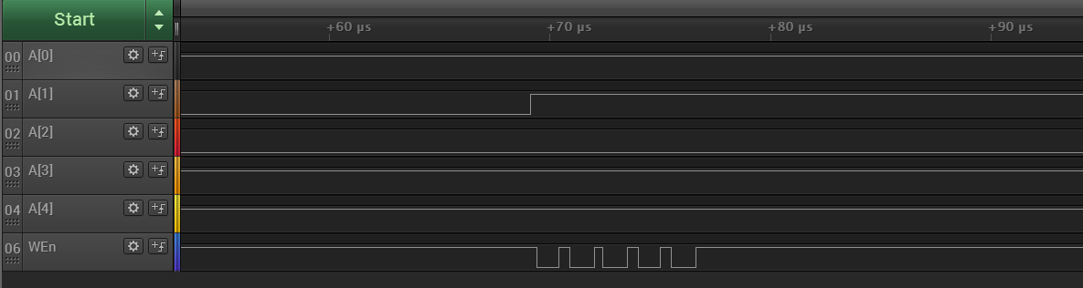

    Thanks for your response, but I'm still confused with the mechanism of EMA_A. I set the ASIZE of CE3CFG to 1 to select a 16-bit bus. And if I understand Figure 20-8 b) of chapter 20.2.5.1 correctly, the EMA_BA[1] is the least significant bit of the address, and EMA_A[x:0] should be other bits. So I test it with code below:
    *(volatile unsigned short*)(0x62000008u) = 0x0000;
    *(volatile unsigned short*)(0x62000008u) = 0x0002;
    *(volatile unsigned short*)(0x62000008u) = 0x0004;
    *(volatile unsigned short*)(0x62000008u) = 0x0008;
    *(volatile unsigned short*)(0x62000008u) = 0x0010;
    0x62000008 is the address of Address Register according to StarterWare example.
    And I monitor the EMA_A[4:0] which suppose to be bit 5:1 of the address. And I also monitor the EMA_WEn signal.
    Since we have written 0x0 to 0x10, I expected A[5:0] should be read as 0x0 to 0x08. But the level of those lines are only changed at the first falling edge of the EMA_WEn signal.
    Albert
  • Hi Sahin,
    Aha, your guidance on 20.2.5.6.3 helps me a lot! I think it makes sense now:
    Here is another test:
    *(volatile unsigned short*)(0x62000010u) = 0x0002;
    And those addresses are changed:
    Those address line expresses the address offset where we R/W data which is even more convenient than I thought!
    Thanks a lot!
