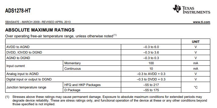

 what is  adc channel input max current (continuous) of ads1278?

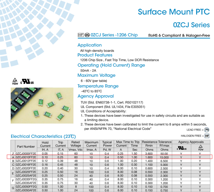

I will try to limit the max adc channel input current using PTC.  .
It will prevent the adc channel from being corrupted by overcurrent.

I want to know the instantaneous maximum current value and the continuous maximum current value.
