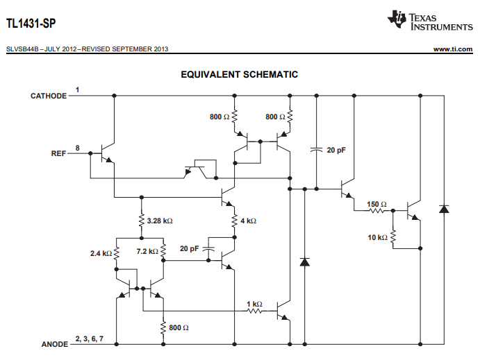

Part Number: TL1431-SP
Do you have any aging data on this reference? If not, could you tell me what type it is (bandgap, buried Zener, etc.)
