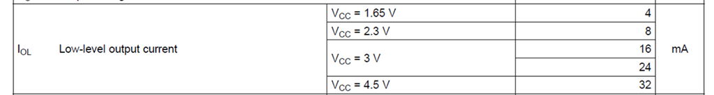

How much current can I sink with the SN74LVC1G07MDCKREP if I’m powering it with 2.5V?
There is a note on the datasheet that says I can sink 32mA of current, but does that mean at a certain supply voltage?
This is the table provided:
    The engineer supporting this device will respond to your question early next week when he returns to the office.

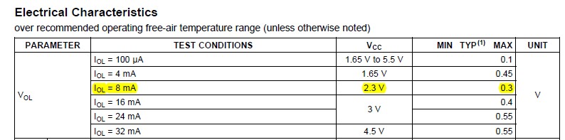

  • Blake, the IOL table indicates that at the 2.5v node (min of 2.3), that the device will sink 8mA and still meet the VOL specification of 0.3V.  This can be seen in the VOL table.
    And, yes the current rating will depend on the voltage node.  The table shows the standard minimums for the common voltages nodes (1.8, 2.5, 3.3, and 5V)
