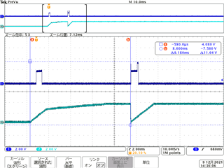

We are using SN74LVCH16T245.
A side connect the power supply +3.3V ,and connect the FPGA output (LVCMOS3.3V).
B side connect the power supply +5V ,and connect the input of ULN2803ADWR.
The direction is A → B.
All OEs are GND. ALL DIR is +3.3V connection.
The attached photo shows the waveform on the B side (8 pin) of the SN74LVCH16T245 on the top, and the rising waveform of the +3.3V power supply on the bottom. It is unclear that the waveform on the output is in the signal of about 2V, probably because the direction changes from B to A until +3.3V rises. In addition, +5V has started up firster than +3.3V.
Probabily,FPGA signal is in the OPEN state.
Please tell me the reason for this phenomenon.
And please tell me the cause and countermeasures.
  • I will attach a waveform photo。
  • The minimum supply voltage at which correct operation is guaranteed is 1.65 V.
    The datasheet says:
    To ensure the high-impedance state during power up or power down, OE should be tied to VCC through a pullup resistor.
    And there is no guarantee that floating bus-hold inputs power up in the desired state.
    I see two alternatives:
    1. Enable OE only after the FPGA has powered up and outputs valid signals; or
    2. use a buffer with TTL-compatible inputs (e.g., SN74AHCT16541) as level shifter, and add pull-down resistors at its inputs; it runs only from the 5 V supply, so its outputs will drive low before the 3.3 V supply powers up.
