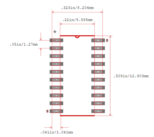

  • Hello Clemens-san
    I downloaded the CAD symbol (from UltraLibrarian) from the SN74BCT245 web page.
    The size of the footprint will be 85mil x 22mil.

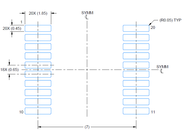

    Is it possible to provide package size information in the following format?
    In this example
    ・20×(1.85)
    ・20×(0.45)
    ・(7)
    With these three pieces of information, you'll have better footprint information.
    best regards
    cafain
  • Hi cafain-san,
    The information we provide is formatted to match TI standards.
    As Clemens said, with this size/type of package, the footprint is not critical to system design.
    You can use the UltraLibrarian files that we recommend, or you can build one yourself and adjust the pad sizes to your liking. I would guess that you have other NS package devices in your parts list -- you can use the same dimensions for the pads from an existing design or a similar device.
