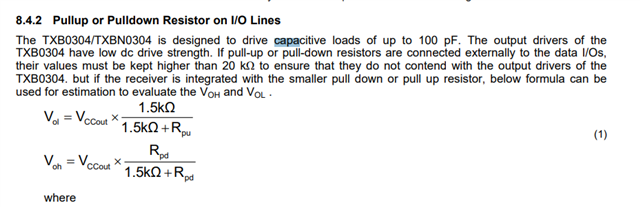

we experience SPI voltage drop while using TXB0304RUTR as the voltage translator
The voltage drop is due to load capacitance higher than spec (100pF)
There are no point to add the pull up in the board
Are there any drop in part that have higher load capacitance tolerance (>100pF) than TXB0304RUTR
