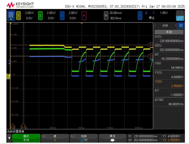

1、It is required to achieve 3.3V to 5V PWM square wave output, using the recommended leakage circuit, FPGA leakage output, 3.3V power supply on the A-side, and 1.5K pull-up resistance; B side is connected to 5.0V power supply, the pull-up resistance is 1.5K, and the EN pin is 200K; The current A side output 3.3V high voltage, B side high voltage is less than 5V, only 4.6V, the current A side output low level, the actual test B side voltage of 4V, the actual test is as follows, yellow, green and blue are respectively B side, EN foot, A side measurement, why do such problems occur?

  • The LSF is a passive switch. For correct operation, you have to take into account the analog properties of all connected devices, and if the driver does not have enough drive strength, achieving the desired speed might not be possible.
    Better use a buffered translator like the TXU0101/TXU0102/TUX0104.

  • Hi Simba,
    Clemens' is correct here- the logic high state is achieved through the external pullups with the transition edges based on the RC of the pullup and output cap. used. Using a buffered translator will help drive these edges and provide improved signal integrity.

  • At the beginning of operation, the A side is 3.3V PWM square wave, the B side is 5V PWM square wave, after 20s, the B side square wave begins to be abnormal, the high level is less than 5V, gradually becomes smaller to about 4v, and then fluctuates up and down
  • The high-level output voltage is determined only by the pull-up resistors. So this looks as if your power supply sags.
