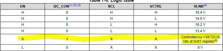

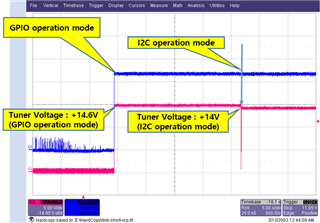

I have a question about the interface of TI LNB IC.
We use I2C and Enable and VCTRL pins are connected to SoC GPIO pins. At this VCTRL pin = "low".
In this setting, the LNB Out voltage is it operates as 14.6V -> 0 -> 14V (I2C setting value). Is this enable and VCTRL setting okay?
