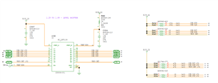

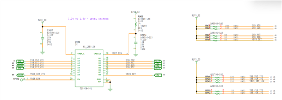

We are using LSF0108 in one of our designs to level translate signals between FPGA IO(1.2V) and USB3320
The max signal frequency is 60MHz and the data are bi-directional.
We have connected 2.5V to VREFB to maintain the BIAS Voltage
Could you let us know below circuitry is ok for the scenario mentioned
Rohini
  • This might work. But I do not know if the pull-up resistors are sized correctly. Both the other devices must be able to sink the total current through both resistors, and the low-pass filter formed by the pull-up resistors and the trace/device capcitances must not filter out your 60 MHz signals. I do not know these parameters.
    A buffered, direction-controlled translator like the TXV0108 might be a better idea; ULPI has the DIR signal for this.

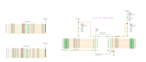

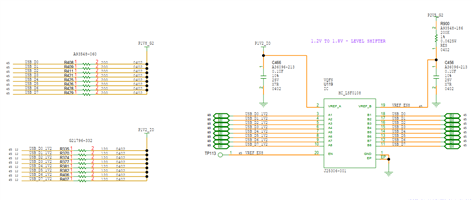

    1. I have updated the Pullup values for
    Data frequency of 60MHz
    IOL of MAX10 is 10mA
    IOL of USB3320 is 8mA
    Pin Capacitance @1.8V device is 4pF
    Pin capacitance @1.2V device is 10pF
    As per calculated below calculation we are using 475E(1% Tolerance) Pullup on 1.2V side and 576E(1% Tolerance) pullup on 1.8V side. Please confirm the tuned pullup values are good to go
    USB  Va 1.2       MAX10
    Ra 475
    Ca 2.3
    DATARATE 152.5553013 MBps
    Vb 1.8   USB3320
    Rb 576
    Cb 4
    DATARATE 72.33796296 MBps 5.651315789 Iol
    2. LSF0108 bias voltage is 0.8V and we are translating signals from 1.8V to 1.2V and vise versa
       To maintain the Bias voltage, we have connected 2.5V to VrefB but pullups(576E) on I/Os are connected to 1.8V. Hope this is fine
    Awaiting for your reply
    Rohini
  • The MAX10's drive strength at 1.2 V is only 2 mA, but your total pull-up current is more than 5 mA. And you have to include the capacitances of the traces and of the LSF.
    As far as I can see, ULPI has pull-down resistors on the data lines, so you must not use a translator that requires pull-ups.
