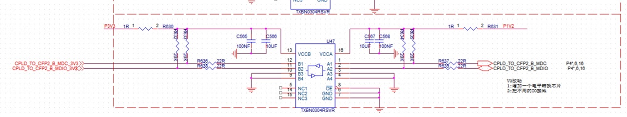

As shown in the figure below:

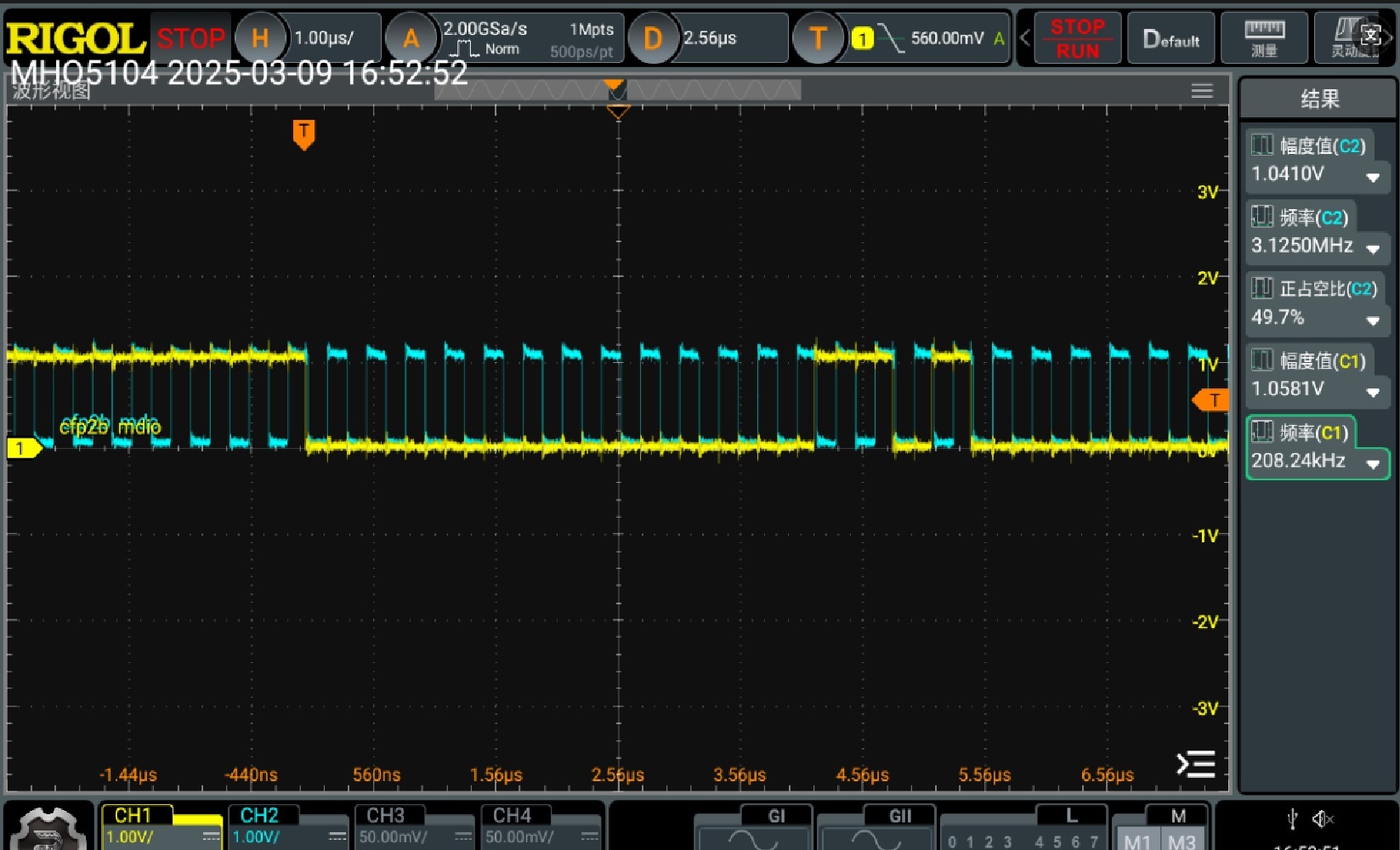

We are using TXBN0304 for level conversion of a set of MDIO signals, where the VCCB side operates at 3.3V and the VCCA side at 1.2V.
Following the datasheet recommendation, I used 20K pull-up resistors on both ends as these signals are open-drain, hence requiring pull-ups on both sides.
However, during testing we found that the high-level voltage on the 1.2V side only reaches 1.0V maximum, which we consider too low. We aim to adjust it to at least 1.1V or higher.
Therefore, I plan to modify the pull-up resistors R634 and R635 (VCCA side) to 18K while keeping R632 and R633 (3.3V side) at 20K. Please help confirm if this is feasible.
When modifying VCCA side pull-up resistors to 18K, does the VCCB side also need to be adjusted to 18K? If the MDIO levels on the VCCB side already meet requirements, can they remain unchanged?
thanks!

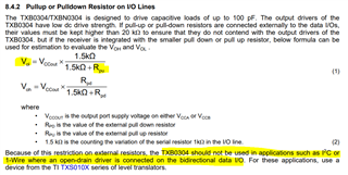

    TXB-devices are not suggested to be used with open-drain drivers. The open drain output is unable to drive the inputs of the TXB high, and if pullup is used/ strong enough, the TXB is too weak to override it. For MDIO/ MDC signals, I would suggest using the TXS0104E/ LSF0204 instead.
    The impact of the pullups will result in shift in VOL, see formula provided in datasheet:
