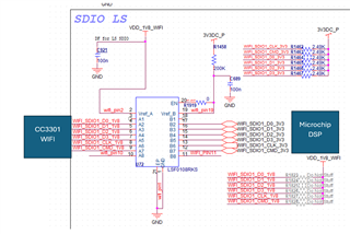

I'm using LSF0108 for SDIO communication between Microchip DSP 3.3V (ATSAMA5D27C-CNR) and Ti WIFI chip 1.8V (CC3301)
See attached Schematics
For B side I having PU Resistors of 2.49k
For A side I having NO PU Resistors
Pins 3,10,11,18 are Not in use

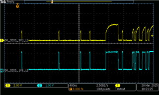

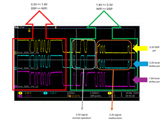

I have measured the CMD and Data signal at I see that during the translation up (meanig 1.8V =>3.3V, from WIFI to DSP) my signal is less square and looks more capacitance
you can see from the pic  above that it  the begging of the translation up the signals looks OK, but after the malfunction start

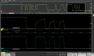

In this pic I have measured the Do signal:
  • The LSF is a passive switch. After the rising edge of the output has reached 1.8 V, the remaining part of the edge is generated only by the pull-up resistor. Weaker resistors make the edge slower.
    The CC3301 has a specified drive strength of 4 mA, so you can use 3.3 V pull-ups as strong as 825 Ω. Try 1 kΩ.
    The only way to reduce the capacitance would be to reduce the distance between the DSP and the LSF.
  • Hi and thanks for the very quick response.
    We already tried to reduce the PU to 1K but we didn't see any changes - We got the same behavior.
    Also its look that the issue is appeared only in one direction of the communication (From the LSF to the DSP)  the second direction look ok .
    Do you think that PU on the 1.8V side (CC3301) can help to achieve higher drive strength ?
    Can LSFQ can be more suitable for our design ?
  • A PU on the 1.8 V side would not help.
    The -Q1 device works in exactly the same way.
    Use an SDIO translator like the TXS0206.

    When measuring the voltage Vin low (from our CC3301 to the LSF and from the LSF to our main MCU) we measured as below
    * Vout low from the CC3301 is 300mv to the LSF
    * Vout low from the LSF to our main MCU is 320mv
    Meaning that only 20mv is the voltage drop on the LSF and its work properly.
    So now the focus is to understand why VOL of the CC3301 is such high (With PU of 1K on 3.3V side)?
    This is mean that internal resistor to GND inside the CC3301 around 80/90 Ohm
  • The CC's output pin must sink the current through all pull-up resistors. With higher pull-up currents, a higher VOL is expected. (The CC3301 datasheet specifies 0.45 V for 4 mA, i.e., 112.5 Ω in the worst case.) As long as it is below the other device's VIL limit, this is no problem.
