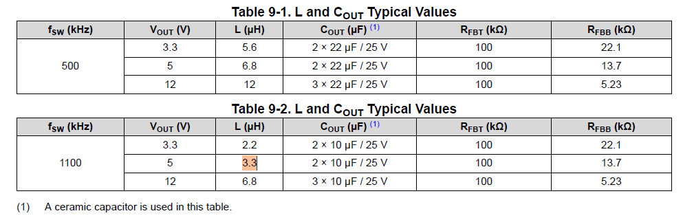

My customer used to use LMR51430YDDCR for power supply and input voltage range is from 18V to 30V(TYP 24V). Output is 5V/3A. Inductance is 3.3uF, same as the value in datasheet.
Due to the supply issue of LMR51430, customer wants to use LMR51420 to replace it and don't want to change peripheral circuits.
So their question is that can they still use 3.3uH inductance when they use LMR51420 to replace LMR51430.

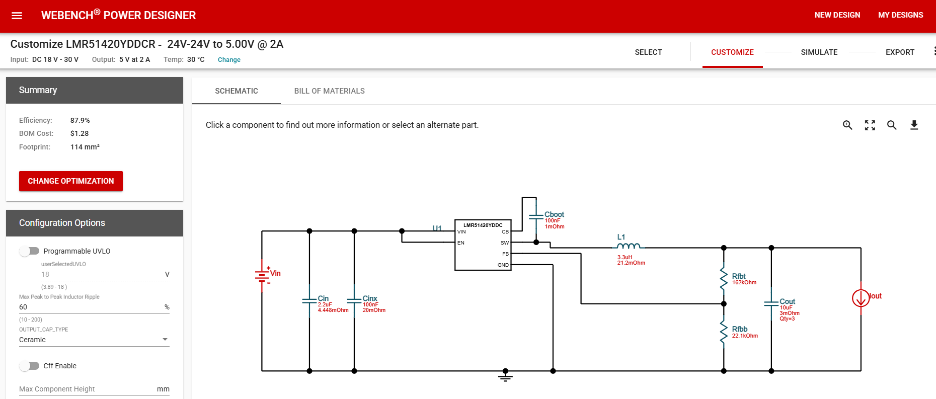

I use Webench and the result shows as below:
I need to change peak to peak inductor current ratio from 40% to 60%, which can achieve small inductor from 4.7uH to 3.3uH.
Bad news is that inductor current will increase. Is it ok for IC Over Current protection?
