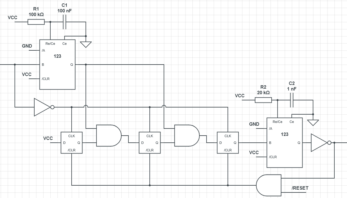

Hello
I want to make a circuit to monitor the status of reset signal of the Micro.
The reset signal is a low level 20us signal.
If I receive 3 pulse in 10ms, I would like to output a pulse. And I would like to bypass the first pulse.
Do you have an idea of this kind of circuit?
