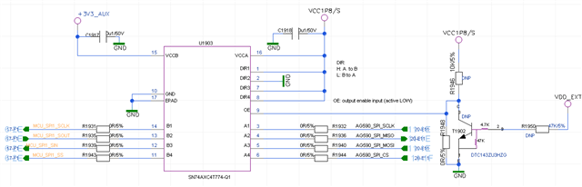

Can you please review the CAXC4T774QBQBRQ1 SCH as below?
BTW, can CAXC4T774QBQBRQ1 support 20MHz SPI interface? Thanks

Hello Xiaowei,
The schematics look good. Yes, the AXC4T774 can support 20MHz SPI interface

Hi Josh,
Thanks for your reply. Can TXB0104-Q1 support 20MHz SPI interface?
Xiaowei Zhang
Hello Xiaowei,
The TXB0104-Q1 can support up to 20MHz (when operating VCCA = 1.8V and VCCB = 3.3V). However, I would recommend going with AXC4T774 instead.
TXB supports auto-sensing which limits the output current drive. If you plan to use longer traces, then AXC would be the way to go.
