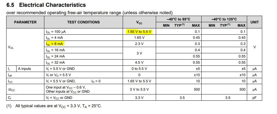

I need VOL max value with VCC=1.8V and IoL=8mA. How can I calculate with this tabe? Please advide.
Vignesh.M

This table does not provide any information about currents larger than 4 mA for VCC = 1.8 V.
The IBIS model says that in the worst case (VCC = 1.71 V, 125 °C, weak process), VOL for 8 mA is 0.233 V.
Hi Vignesh,
I believe these FAQs should be able to help:
[FAQ] What method is best used for estimating specification values between those given in the datasheet?
[FAQ] How do I determine the output voltage (VOH, VOL) or output current (IOH, IOL) of a CMOS logic device?
