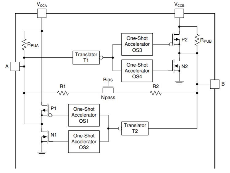

Part Number: TXS0108E
could you help clarify when will the NPASS gate function?
Thanks.
BR
Mason
Assume that the gate is biased to VCCA.
When both A and B pins are high, the transistor is off.
When either A or B is low, the transistor switches on, and thus propagates the low voltage to the other pin.
