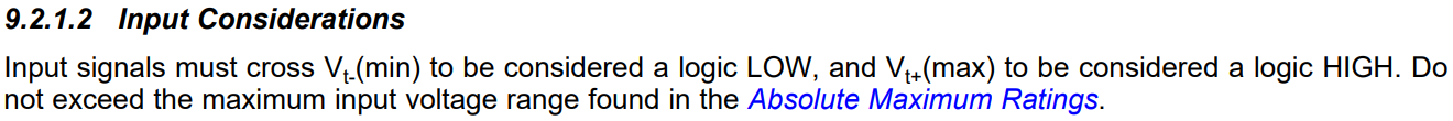

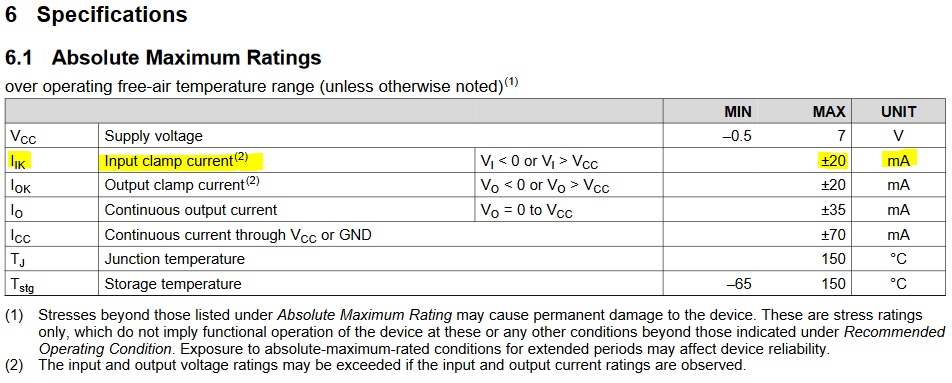

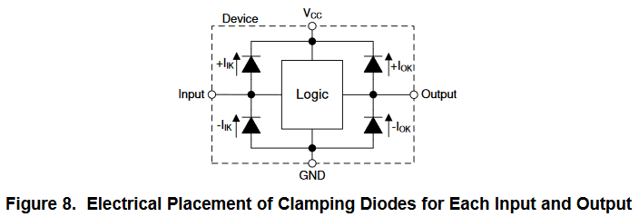

Dear Sir/Madam,
I am planning to use SN74HCS126QPWRQ1 Schmitt Trigger Buffer to interface Optical encoder switch.
Optical Encoder Switch Voltage Levels:
VCC=5V,
VOH min =  3V
VOL max =  1V
Schmitt Trigger Voltage Levels:
at VCC=4.5V,
VT+ min = 1.7V,  VT+ max = 3.15V
VT- min = 0.9V,  VT- max = 2.2V
We want to know following clarifications.
1. Can I interface Schmitt trigger with Optical encoder switch without any logic voltage level issue when Schmitt trigger supply is 5V?
2. It is given in Application report ( Link: https://www.ti.com/lit/an/scea046/scea046.pdf) that "the input levels Vih and Vil must be greater than (VT+ max) and less than (VT– min) to insure the part will switch".
As per this statement we shall not interface Encoder switch with Schmitt trigger when I operate at 5V. Can you please suggest us an alternate Schmitt trigger buffer part number which i can interface optical encoder with good Noise margin?
3. For SN74HCS126QPWRQ Schmitt trigger at 3.3V and 5V VCC, what will be the  VT+ and VT-  range ?
4. Are Schmitt trigger inputs of SN74HCS126QPWRQ1  are 5V tolerant?
