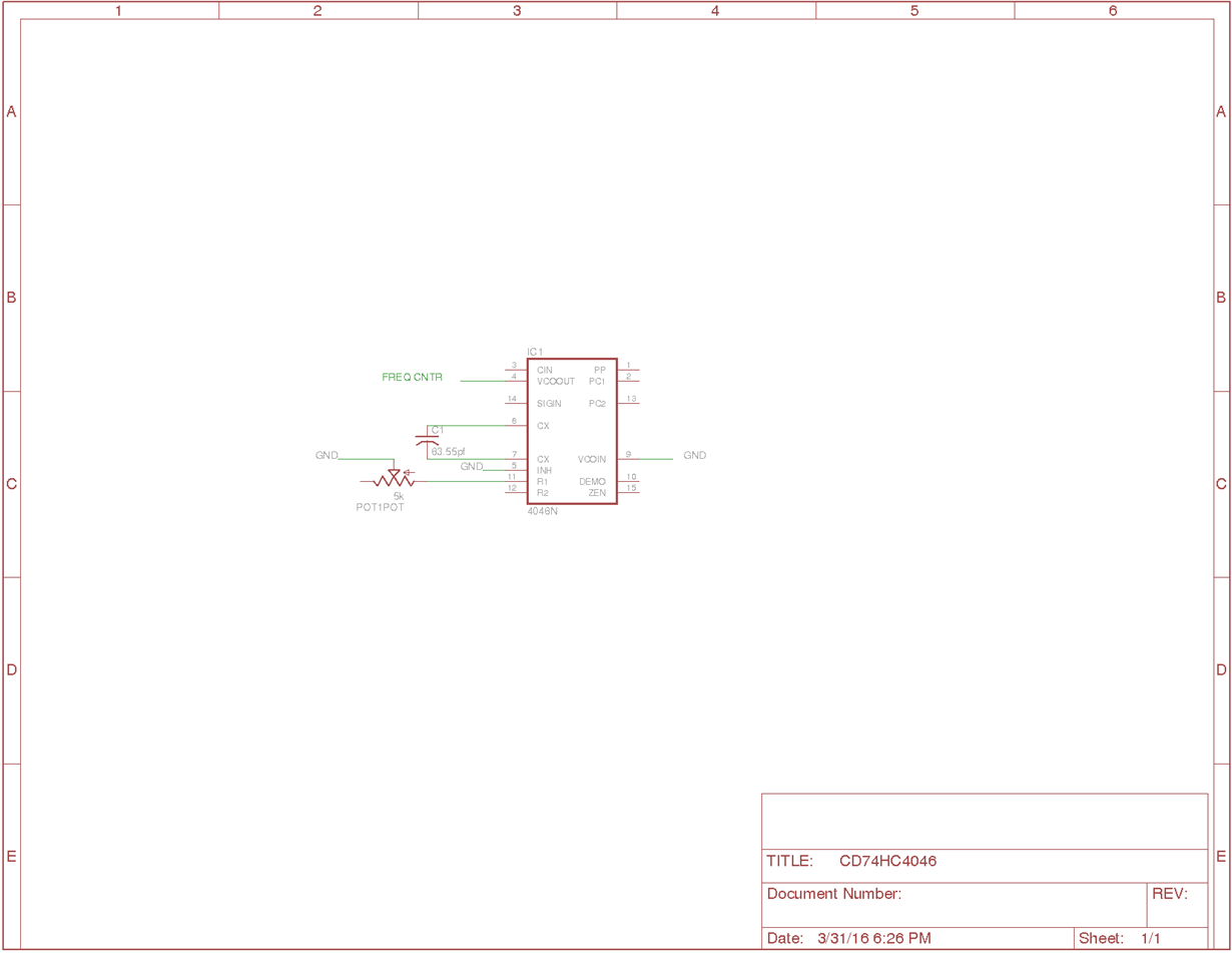

I am having difficulty setting the VCO frequency for the 74HC4046. I want to set its frequency by a varactor diode in the C part of the circuit. The main capacitor is a capacitive sensor that is 63.55 pf. I want to add to it a varactor diode whose capacitance is controlled by phase detector. For my first test I have my capacitive sensor as C It is stable and set to 63.55 pf. R2 (pin 12) is infinite (open) and R1 (pin 11) is a pot of 5k to zero. VCOIN (pin 9) is grounded. I want to set the VCO to 13.56 MHz. It adjusts up to 12 MHz but then jumps sometimes to 17 MHz and also 24 MHz. Maybe I should make my own VCO but I don't have the circuit for the VCO in the 4046. Any ideas you have would be greatly appreciated. Thank you. Alvin...
