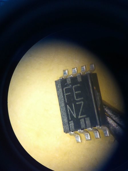

Hi, i can't understand where is the pin 1 index from data sheet. Can you tell me which pin is pin 1.
  • Canberk,
    I've marked Pin 1 (green circle) as shown below:

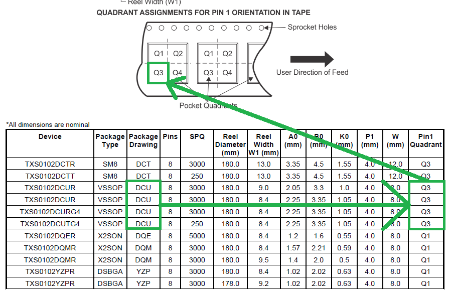

    The datasheet indicates the Pin 1 location as shown below. You need to look at the orientation of the TXS0102 within the tape to determine Pin 1 orientation.
