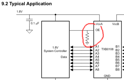

TXB0108 OE pin has internal Pull down resistor ?
Hi Clemens,
Are you referring to TXB0108 data sheet ?
I don't see figure 9-1 and section 11.2). relevant to mentioned topic
Thank you Clemens / Dilip.
In current design. I don't have option for external pull-down. Only option for Pull-Up is available. I need to disable the device. Hence, I was checking whether the device do have a internal pull-down.
Vinod.A
The only way to disable the TXB is to pull OE low, or to force VCCA or VCCB to 0 V.
