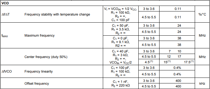

There seems to be a complete void for information on how to set the VCO characteristics of the SN74LV4046 with C1, R1 & R2. There are no usable charts or formulas that I can see in the SN74LV4046 part spec.
What am I missing?????
