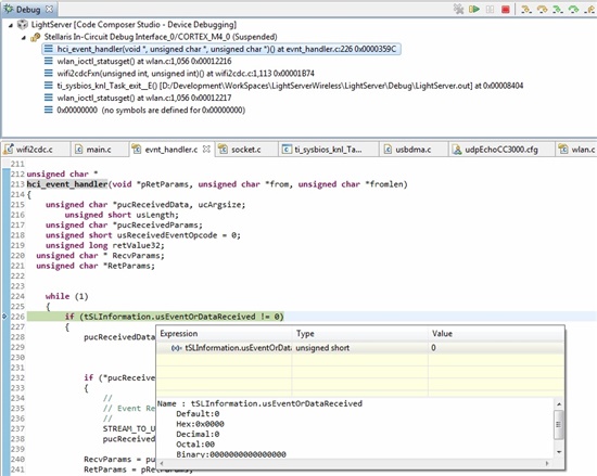

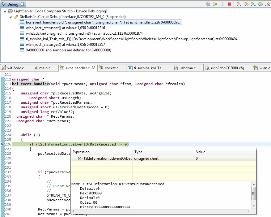

  • I am experiencing this issue also. In that it gets stuck in the hci_event_handler loop.
    When I look at the stack, it seems to be the select() statement that initiated the issue.
    My setup is as follows:-
    I have 2 UDP sockets. 1 is a regular socket listening on the CC3000 IP address. The other socket is a broadcast socket listening on 0.0.0.0.
    My first regular socket does not have issues, I am receiving packets at about 20 per second. It does not however perform any sendto() after this, as it processes the data internally and sends out to attached hardware via USB or SPI.
    My broadcast socket is set up to echo data back to the device that sent it the broadcast packet. It does use a sendto() to do this. This is the socket that is having issues.
    I am on the latest service pack 1.24. I am using everything TI, including the Tiva C LaunchPad, the CC3000 BoosterPack and CCS 5.5.
    I have tried a number of different configuration setups for my broadcast socket, including timeouts, buffer size etc, the only thing that reduces the speed with which this issue occurs is to reduce the number of packets being sent to the CC3000.
    This issue also seems to occur if I am not even sending broadcast packets, but just my regular packets used by my regular socket (even though it does not perform a sendto - need to verify this scenario is not an unrelated issue with my App). I have 2 separate selects for each socket in my main program loop. I was hoping that my code was the issue, but it seems from this post, that it is unlikely the cause.
    I will try the delay solution suggested by Markus and report back. As mentioned above my packets are broadcast packets, so we will see how it goes.
  • Here are what my additional tests reveal.
    I have tried a delay of 500ms after the sendto() and this has made no difference when sending broadcast packets.
    Sending packets to my regular socket that does not execute a sendto() does not cause the issues. But it does seem to speed up the process.
    It takes a lot longer for the issue to occur when I have it attached to a debugger. When not attached, I am sending a broadcast packet every 0.5 seconds and it then takes about 30 minutes for the issue to occur.
    My app does not usually send these broadcast packets, it sends the packets till it finds the CC3000 device, and then stops sending broadcast packets, so I will not usually be hitting it so hard, but I am concerned this issue could still cause instability over longer periods. I am also wanting to put in place a heartbeat, so it can check every minute that the device can still be found.
    Here is the stack backtrace:-
    This time it seemed to be trigger by the wlan_ioctl_statusget() in my code, it is included in the main program loop and will make the LED flash if the CC3000 loses connection with the Wifi Router. It was connected and fine at the time of the issue.
    wlan_ioctl_statusget() does contain hci_command_send(...)
    Even though I am experiencing the same conditions as posted by others. I am going to investigate whether this is my code. I need some verification that my method of configuring 2 sockets (1 regular and 1 broadcast) and the way I use select() in the main program loop is the correct way to go about things.
    Oh and some further info, similar issues have been raised in this forum a number of times:-
    Sometimes hang in hci_event_handler - http://e2e.ti.com/support/low_power_rf/f/851/t/295158.aspx
    Event_handler_hci in cc3000 - http://e2e.ti.com/support/low_power_rf/f/851/t/303733.aspx
    recv api hangs erratically - http://e2e.ti.com/support/low_power_rf/f/851/t/316867.aspx (This may provide details on a work around)

    The solution posted by the OP does not really work for me, since I am not using a RTOS, and both are running in the same thread.
    I assume this is being exaggerated for me due to the number of debug messages I have added to the code to solve a problem I was having previously, or possibly the speed of my chip (LPC1114).
    I am going to try to remove all my debug messages and see if this happens less frequently, but this is clearly a flaw in the code, which can lead to never ending loops.
  • Note that becoming stuck in this loop can happen for a number of reasons, including an incorrect SPI driver implementation.
    Since setting usRxEventOpcode prior to sending gets you past a command it does sound like this is at least part of the problem.
    I haven't went back to try and determine why setting this variable first didn't appear to be a permanent fix. To my understanding it should have been unless an asynchronous event can somehow interfere... Did you try disabling the keep alive events?
    I have found that a logic analyser is more or less necessary for debugging the CC3000.

  • I came across the same problem and fixed it, but not by slowing down interrupt processing with a wait.   The problem is exactly as Alan described...
    The main thread calls hci_command_send() which sends the command to the CC3000 via SPI, then it calls SimpleLinkWaitEvent(). SimpleLinkWaitEvent sets the tSLInformation.usRxEventOpcode variable so that when the interrupt hits for the response, the interrupt code knows which op code is being waited for. Then SimpleLinkWaitEvent goes into a loop waiting for the interrupt code to indicate that the response message has arrived.
    More specifically, when the interrupt comes, it calls the unsolicited ("non-host initiated") interrupt handler first to see if the message received is one of the known unsolicited messages. If not, it then compares the opCode of the incoming message to tSLInformation.usRxEventOpcode to see if it's something the main thread is waiting for. If it doesn't match tSLInformation.usRxEventOpcode, it blows off the message entirely.
    The problem, as Alan described, is that the main thread sends the command to the CC3000 then the interrupt happens before the main thread gets a chance to set tSLInformation.usRxEventOpcode. So, the interrupt handler blows off the message and the main thread remains in an infinite loop.
    The solution is to set tSLInformation.usRxEventOpcode BEFORE hci_command_send() or hci_data_send() send the commands to the CC3000. So, comment this out in SimpleLinkWaitEvent() in evnt_handler.c, and add it instead to the top of hci_command_send() in hci.c:
       tSLInformation.usRxEventOpcode = usOpcode;
    Unfortunately, hci_data_send() doesn't get the opCode, so you can't add it there, but it's only called once in simple_link_send() in socket.c, so change the code at the bottom from this:
    hci_data_send(opcode, ptr, uArgSize, len,(UINT8*)to, tolen);
    if (opcode == HCI_CMND_SENDTO)
       SimpleLinkWaitEvent(HCI_EVNT_SENDTO, &tSocketSendEvent);
    else
       SimpleLinkWaitEvent(HCI_EVNT_SEND, &tSocketSendEvent);
    to this:
    if (opcode == HCI_CMND_SENDTO) {
       tSLInformation.usRxEventOpcode = HCI_EVNT_SENDTO;
    } else {
       tSLInformation.usRxEventOpcode = HCI_EVNT_SEND;
