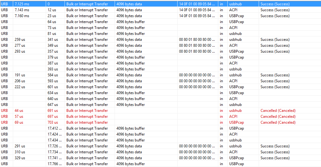

I am stuck trying to debug an issue with some USB DMA transfers from my device to a host computer. The microcontroller interfaces with an external USB 2.0 PHY chip to send data as a device to a host computer using a bulk endpoint.
The bulk endpoint is configured such that transfers occur in chunks of 512 bytes. I use the integrated USB DMA controller to send a dataset of 16,384 bytes to the host computer over this endpoint.
On windows 8, this implementation worked just fine and there were no problems at all with receiving the data on the host computer, but after attempting to use the same hardware/software on a windows 10 setup, the device fails to get all of the data to the host computer.
One difference that I notice is that there are some bulk/interrupt transfers that get canceled instead of completed on the windows 10 side. This does not occur on windows 8. Below are screenshots of the behavior I am seeing using USBLyzer to analyze the packets:
Windows 8:
Windows 10:
Could anyone point me in the direction I would have to go with this? Right now the microcontroller just gets interrupted once the full 16kb block of data is sent over so I have no idea whether or not I am dropping packets or if things are getting canceled.

    Quite sadly, my application does not know that the packets have been dropped. From what I can tell my processor gets interrupted once and only once when the entire data set has been transferred over by the integrated USB DMA controller. The application believes that it has completed sending all of the data.
    I have noticed however that sometimes the USB transfer takes an extra amount of time as below:
    Please excuse the weird configuration of the packet capture software... What is shown here is a transfer of 16,384 bytes that seems to show up as four separate transfers of 4,096 bytes. If you look carefully you could see that there is a huge time delay between the reception of the "third chunk" of 4,096 and the "fourth chunk". One would assume that all of the transfers would occur in a uniform amount of time, but occasionally a delay like the one shown above occurs.
    For some reason this creates a problem in Windows 10, but not in Windows 8...  Perhaps if I can solve the issue of this strange intermittent delay then I can solve the problem on Windows 10.

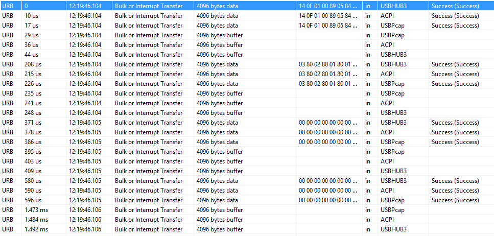

  • Hi bryan,
    Here is a part of your USBlyzer capture,
    The first three lines mean request phase URBs, falling down over the three driver stack layers (USBPcap, ACPI, USBHUB3). The next three lines show completion phase URBs, rising up the three drivers in reverse order. That is, these six lines represent a record of single request-completion pair. The next six lines are also another request-completion pair. Now that the delay occurs after the first completion, before the second request. No USB transfer occurs on the bus wires in this period. This delay is caused by the Windows driver (usbser.sys or WinUSB?), or by your PC application.
    What is the PC driver?
    If it is usbser.sys (CDC), increase the input buffer size using SetupComm( dwInQueue ) API, so that the input buffer of the driver could hold entire transfer.
    If it is WinUSB, check the buffer status supplied to WinUsb_ReadPipe(). Is the buffer allocated "fixed" against garbage collection?
    Though it is a minor problem,
    You are using USBlyzer and WireShark (USBPcap), simultaneously. Applying two or more software sniffers at the same time is bad idea. They may conflict each other. At least, software sniffers add slight delay, as your record shows (USBPcap adds a couple of micro-seconds). Uninstall previous sniffer, before installing new one.
    Tsuneo
