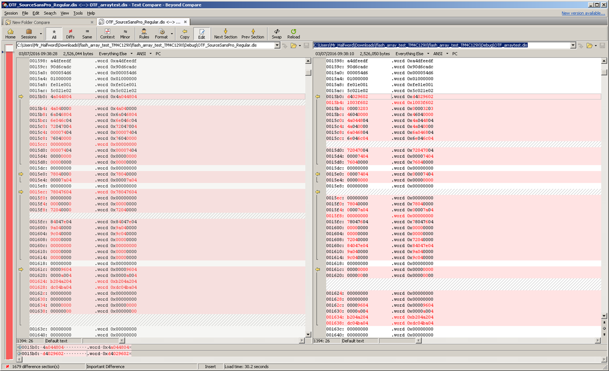

  • tinyspud said:
    compiler's just really weird with files that large (guessing text files or something) which isn't really that surprising and I"m not 100% what the solution should be other than breaking it into a bunch of files and having the linker align them.
    Can you try running the armdis dis-assembler program in the TI ARM compiler on the .out file, using the --all option to dis-assemble all sections. That should give a hex view of the array in the executable and allow you to see if the problem is in the .out file or not.
  • Hi Chester
    Thanks - did the comparison so it turns out that I was able to get it to compile correctly (verified by the binary via .out file) with the comments in the file stripped out.  Turns out the array's contents were getting confused probably by literally the thousands of comments the file so when it was parsing it to compile it and fill the array it was skipping lines (which explains why the pieces missing were 16B at a time) since my file was organized with each line with the comments describing the address location in them (like each line beginning with /* 0x00000010 */ then 16 bytes defined in hex then every 16th column pointing out 0, 1, 2, ..., F).  Modified my program that I ran the binary files through to create the arrays to not include the comments and looks like everything's working.
    Thanks everyone, learned some interesting new tools for the toolbelt.

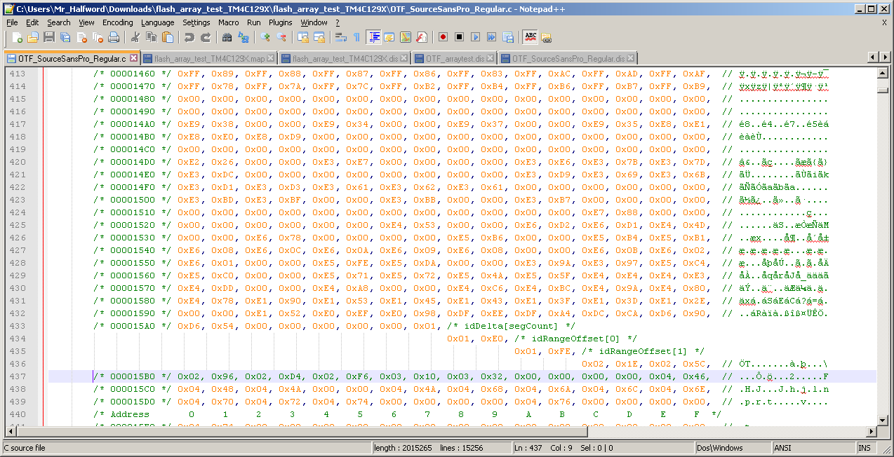

    Are you able to post a version of the complete project with the array definition containing the comments and the resulting .out file?
    Given that you appear to have found a problem in the compiler parsing of large files, if I can repeat the problem then will report the problem in the TI C/C++ compiler forum.
  • No problem; attached.  I think it's attached here...Let me know if this isn't working.  I'm using CCS 6.1.3.00033; think everything on here's up to date.flash_array_test_TM4C129X.zip
    I see that there are two array definitions, OTF_SourceSansPro_Regular.c contains comments in the array and the OTF_arraytest.c contains no comments in the array.
    I used armdis to dis-assemble the OTF_SourceSansPro_Regular.obj and OTF_arraytest.obj object files and used BeyondCompare to compare the dis-assembled contents. As these object files only contain one large array the offset shown in the disassembly is the offset into the array. The first difference is at offset 0x15b0 in the arrays:
    I used Notepad++ to look in the OTF_SourceSansPro_Regular.c to view the array contents at offset 0x15b0:
    Note that the C syntax color highlighting in Notepad++ is showing the contents of line 437, which is supposed to be array data from offsets 0x15B0 to 0x15BF, as a comment since the hex values are shown in green. The previous line 437 ends with a '\' which is a line continuation character in C which means the contents of line 437 is considered as a continuation of the // comment at the end of line 436.
    Therefore, I believe the problem is how the auto-generated array file with comments is generated. If you change the generation to write a space at the end of each line, i.e. after the ASCII dump, then I think any trailing '\' in the character dump will no longer cause the next line to be parsed as a comment and thus avoid the issue where some of the array contents gets "commented out".

  • I was suspecting something like that.
    Two follow on notes
    Many compilers will warn when this occurs. I don't know if ccs is of high enough quality. Make sure you understand why your warnings occur
    Second, static analyzers such as PC-Lint definitely complain about this condition with clear messages. PC-Lint would have paid for itself just finding this for you
    Robert

    ../OTF_SourceSansPro_Regular.c:5708:114: warning: multi-line comment [-Wcomment]
       /* 00015420 */ 0xDA, 0x15, 0x13, 0xF9, 0x80, 0x30, 0x1D, 0x32, 0xFD, 0x0E, 0x59, 0x0A, 0x13, 0xFA, 0x80, 0x5C, // Ú..ù.0.2ý.Y..ú.\
    ../OTF_SourceSansPro_Regular.c:5996:114: warning: multi-line comment [-Wcomment]
       /* 000165C0 */ 0x8D, 0x44, 0xD2, 0x5A, 0x76, 0xF8, 0xF0, 0xD4, 0x12, 0xBF, 0xE1, 0xF7, 0x35, 0xD8, 0x13, 0x5C, // .DÒZvøðÔ.¿á÷5Ø.\
    ../OTF_SourceSansPro_Regular.c:6492:114: warning: multi-line comment [-Wcomment]
       /* 00018420 */ 0x1D, 0xF9, 0x92, 0xF8, 0x33, 0x1D, 0xFB, 0x2C, 0x15, 0xF7, 0x46, 0xF9, 0xF0, 0xFB, 0x46, 0x5C, // .ù.ø3.û,.÷FùðûF\
    ../OTF_SourceSansPro_Regular.c:7263:114: warning: multi-line comment [-Wcomment]
       /* 0001B360 */ 0xD1, 0x06, 0x13, 0x7A, 0x94, 0xF7, 0x37, 0x05, 0xE7, 0x98, 0xCF, 0xC3, 0xE3, 0x1A, 0xCF, 0x5C, // Ñ..z.÷7.ç.ÏÃã.Ï\
    ../OTF_SourceSansPro_Regular.c:7400:114: warning: multi-line comment [-Wcomment]
       /* 0001BBC0 */ 0x72, 0x1D, 0x0E, 0xFB, 0x36, 0xF8, 0x90, 0xF7, 0xDB, 0x1D, 0xF7, 0xEE, 0x4E, 0x0A, 0xF7, 0x5C, // r..û6ø.÷Û.÷îN.÷\
    ../OTF_SourceSansPro_Regular.c:7577:114: warning: multi-line comment [-Wcomment]
       /* 0001C6A0 */ 0x7A, 0x7A, 0x8E, 0x75, 0x1B, 0x46, 0x6C, 0x5A, 0x48, 0x1F, 0x61, 0x07, 0x5E, 0x89, 0x05, 0x5C, // zz.u.FlZH.a.^..\
    ../OTF_SourceSansPro_Regular.c:8184:114: warning: multi-line comment [-Wcomment]
       /* 0001EBD0 */ 0xBA, 0x01, 0x72, 0xBD, 0x03, 0xEB, 0xFB, 0x45, 0x15, 0xBA, 0x44, 0xD3, 0x59, 0x43, 0x44, 0x5C, // º.r½.ëûE.ºDÓYCD\
    ../OTF_SourceSansPro_Regular.c:8545:114: warning: multi-line comment [-Wcomment]
       /* 00020010 */ 0x1D, 0x0B, 0xC5, 0x99, 0xC0, 0xA7, 0xD2, 0x1A, 0xC5, 0x58, 0xAA, 0x34, 0x8D, 0x1E, 0x82, 0x5C, // ..Å.À§Ò.ÅXª4...\
    ../OTF_SourceSansPro_Regular.c:8632:114: warning: multi-line comment [-Wcomment]
       /* 00020560 */ 0x93, 0x95, 0x8C, 0x91, 0x1B, 0xA8, 0xA2, 0x81, 0x42, 0xAD, 0x1F, 0xD0, 0xFB, 0x2F, 0xFB, 0x5C, // .....¨¢.B­.Ðû/û\
    ../OTF_SourceSansPro_Regular.c:9684:114: warning: multi-line comment [-Wcomment]
       /* 00024450 */ 0x30, 0x32, 0x0B, 0x4C, 0x73, 0x73, 0x30, 0x32, 0x0B, 0x54, 0x73, 0x73, 0x30, 0x32, 0x0B, 0x5C, // 02.Lss02.Tss02.\
    ../OTF_SourceSansPro_Regular.c:9991:114: warning: multi-line comment [-Wcomment]
       /* 00025720 */ 0x07, 0x8D, 0x00, 0x19, 0x00, 0x34, 0x00, 0x3C, 0x00, 0x44, 0x00, 0x4C, 0x00, 0x54, 0x00, 0x5C, // .....4.<.D.L.T.\
    ../OTF_SourceSansPro_Regular.c:10093:114: warning: multi-line comment [-Wcomment]
       /* 00025D60 */ 0x17, 0x68, 0x00, 0x01, 0x00, 0x00, 0x00, 0x31, 0x00, 0x03, 0x00, 0x00, 0x00, 0x01, 0x17, 0x5C, // .h.....1.......\
    ../OTF_SourceSansPro_Regular.c:10196:114: warning: multi-line comment [-Wcomment]
       /* 000263B0 */ 0x05, 0x55, 0x05, 0x56, 0x05, 0x57, 0x05, 0x58, 0x05, 0x5B, 0x05, 0x5E, 0x05, 0x5D, 0x05, 0x5C, // .U.V.W.X.[.^.].\
    ../OTF_SourceSansPro_Regular.c:10356:114: warning: multi-line comment [-Wcomment]
       /* 00026D80 */ 0x01, 0x30, 0x01, 0x36, 0x01, 0x3C, 0x01, 0x42, 0x01, 0x48, 0x01, 0x4E, 0x01, 0x54, 0x01, 0x5C, // .0.6.<.B.H.N.T.\
    ../OTF_SourceSansPro_Regular.c:10684:114: warning: multi-line comment [-Wcomment]
       /* 00027F60 */ 0x01, 0x0E, 0x01, 0x98, 0x01, 0x26, 0x01, 0x9E, 0x01, 0x9E, 0x01, 0x5C, 0x01, 0xA4, 0x01, 0x5C, // .....&.....\.¤.\
    ../OTF_SourceSansPro_Regular.c:14986:114: warning: multi-line comment [-Wcomment]
       /* 00038560 */ 0xE9, 0xB2, 0xDF, 0xB2, 0xE9, 0xDD, 0x20, 0xC6, 0x71, 0x0F, 0xCD, 0x95, 0x74, 0xDC, 0xB6, 0x5C, // é²ß²éÝ Æq.Í.tܶ\
    ../OTF_SourceSansPro_Regular.c:15042:114: warning: multi-line comment [-Wcomment]
       /* 000388D0 */ 0x37, 0x83, 0x0A, 0x30, 0xBA, 0xB5, 0x44, 0x98, 0xFD, 0xEF, 0xBD, 0xAA, 0x80, 0x35, 0xB1, 0x5C, // 7..0ºµD.ýェ.5±\
    'Finished building: ../OTF_SourceSansPro_Regular.c'

  • Note that the C syntax color highlighting in Notepad++ is showing the contents of line 437, which is supposed to be array data from offsets 0x15B0 to 0x15BF, as a comment since the hex values are shown in green. The previous line 437 ends with a '\' which is a line continuation character in C which means the contents of line 437 is considered as a continuation of the // co
    While this might be an indicator, it is not really a proof. Those internal parsers are not the same as the compiler - every one more than superficially familiar with Eclipse knows this phenomenon. While the parser complains about errors, a build runs successful.
    Running a build (compile) with the "-E" flag and checking the output could help - albeit that might become tedious ...
    BTW, this forum software is having issues with such long lines as in this thread.
    Either the start or the end of the line(s) is shifted out of the visible range, but no horizontal scroll bar anywhere ...

  • Chester Gillon said:
    The MISRA-C:2004 9.2 warning detects that the SourceSansPro_Regular_const[] array has only been partially initialized (see https://sonarqube.com/coding_rules#rule_key=c%3AS835 for an explanation of this MISRA-C rule).
    That should be sufficient to set off alarm bells but it appears you need to put in some effort to get that message. A non fully initialized const array would, I think, always be an error (or almost always). Even non-const arrays are usually non initialized or fully initialized IME.
    Robert
    Agree that wasn't checking the same parser as the compiler. In this case used the disassembly to find the array offset at which data was first "missing" and when viewed the source file in an editor the C syntax highlighting showed the problem. At that point I stopped looking, since had found an explanation without having to check the parser output from the compiler.
    Issues about the parse complaining about errors but the build bring successful are usually caused by difference in pre-defined macros or if parser is set to C++ and and compiler set to C mode (or vice-versa).
