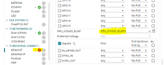

Hi!
we are checking a feasibility on the AM64x SK device to run the following specs -
  • 2x CAN
  • 3XECAP
  • 3XPWM
  • 2 ethercat Clients
  • 1 Ethercat Master
Since I have a resource conflict with adding the 2XECAP with 2XMCAN option, I would like to utilise the ECAP modules on the ICSSGx cores. But not sure why there is a resource conflict here again even though this pin is free-
Looking forward to your advice here!
Madhurya
    Please also note the following -
    We also need to add 3x EQEP (which inhibits from putting EtherCAT Slave on ICSSG0 and forces me to use ICSSG1. When changing the EtherCAT function in the “Industrial Comms” modules from ICSSG0 to ICSSG1, the PRU module is switching to ICSSG1, but the ECAP peripheral in the “additional ICSS Settings” is on PRU_ICSSG0_ECAP0 (I would expect it to change to PRU_ICSSG1_ECAPx ?)
    I have a sysconfig file to showcase this behaviour

  • Hi Madhurya,
    Thank you for your patience while I have been looking into this issue.
