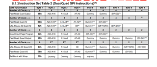

  • Hi Shaoxing,
    How to judge the 1S-4S-4S? Could you give me example show me detailed info? Thanks~
    The device mentioned above and the link associated with it states that its a Quad flash and here is a snippet of the same.
    You should be using 1-1-4 mode.

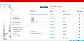

    Q2: I have noticed that W25Q64JVSSIQ- only Dual/Quad SPI, but current SDK only have OSPI-SBL to boot device.
    The SDK supports all kinds of boot and SBL. It is agnostic of the interface.
    You need to choose the correct protocol here -
    Add a correct SFDP table via JSON and it will take care of it. You can get the SFDP table from the example mentioned. https://software-dl.ti.com/mcu-plus-sdk/esd/AM243X/latest/exports/docs/api_guide_am243x/EXAMPLES_DRIVERS_OSPI_FLASH_DIAG.html
    No manual modifications is required for the user apart from the once mentioned in the guide. To give a reference, SBL-OSPI is the same example which works for AM243x-EVM which has Octal Flash and AM243x-LP works with Quad Flash.

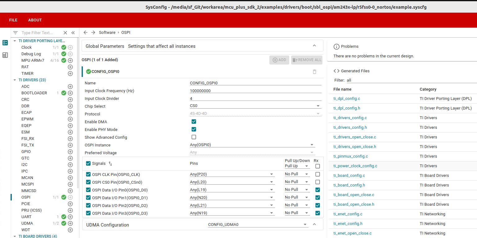

  • Hello Aakash,
    Very thanks for your reply. Since we only have the SBL OSPI example for AM243x-LP. So how to get SFDP table, and Sysconfig has no method to configure the QSPI, as you showed the below figure? Thanks a lot!

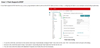

  • Hi ,
    The OSPI Flash Diagnostics run on 1s-1s-1s mode. It queries for the SFDP table. The logs on the terminal can be stored and used as JSON input.
    This is fairly easy if its the first case - software-dl.ti.com/.../CUSTOM_FLASH_SUPPORT_GUIDE.html
    Important NoteAs of now the SFDP parsing in the SDK supports upto JEDS216D standard.
    Aakash
