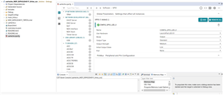

      I don't seem to have the same issue. I click on the .syscfg for uartecho_MSP_EXP432E401Y_tirtos_ccs example and it brings up the GUI for the config. Can you try to reinstall CCS?
  • I installed CCS 12.2 this morning. I'll try another computer.
  • I was able to load and edit the project .syscfg files after uninstalling then reinstalling SDK "simplelink_msp432e4_sdk_4_20_00_12" then re-booting my computer. Thanks for your help!
