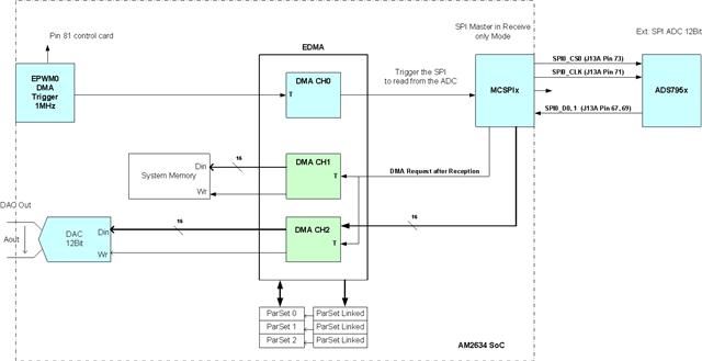

The drawing below shall illustrate what I try to achieve:
Q: What is the best example I should look into in order to adapt it for the scenario shown above?

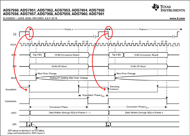

    thank you for picking up. I do have some additional information. We intend to use one of the 12Bit 1MSample ADC from TI. However I am not sure if this will work. Looking at the data sheet of those converters I do get the impression that the falling edge of the CSn signal is needed to move the acquisition to the sampling step within the ADC conversion. See ds extract from TI's product.

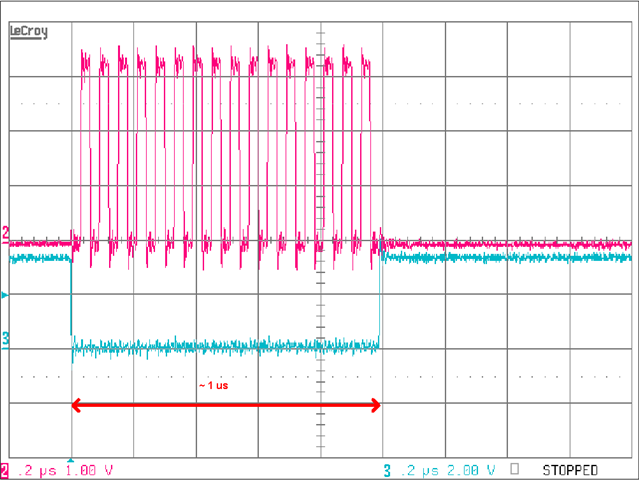

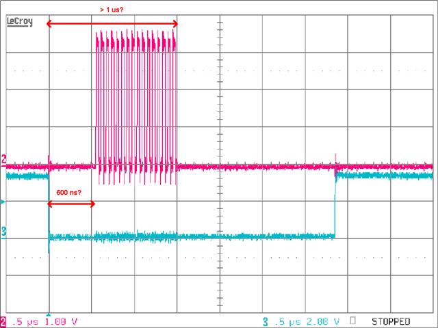

    I was able to change the demo program, still it crashes for a reason I don't know, to generate a 20MHz clock for 16clocks. What bothers me is the time between the falling edge of the Csn signal and the first rising clock edge. Maybe this is driver related. However in my measurements I do measure independent of the selected speed ~600ns until the first rising clock edge.
    Q: How can I shorten this time? Is this driver related or hardware related?
    Also the CSn rising edge must be much closer to the end of the SPI transfer.
    Q: Is this a SW driver issue?
    Update!
    I was able to reduce the timing after the falling edge of the chip select (blue scope trace) within the sysconfig tool. The reduction is to a half SPI clock cycle. This is done by changing the 'Mode of Operation' to Multi Master Mode. This seems to be needed even if there is no multi master scenario. Anyway the clock is being generated but the application is still crashing. A side note to sysconfig: If you do this change the tool will flag a configuration error with respect to the DMA_TRIGGER. You can easily repair this by re-assigning the correct order within the MCSPI configuration section and the error will disappear. Seems to be something that happens in the latest version 1.15.0 as well.

    Q1: I want a periodic trigger from one of the EPWM's to start the SPI readings. How do I achieve this? See 1st img within this thread.
    Q2: EDMA configuration is a point. In the past I did it in a separate code blocks. For the MCSPI it is somehow part of the associated library. I will need to figure out how this is being accomplished without creating to much of confusion.
