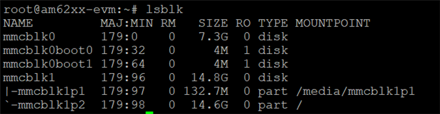

Flash uboot image to emmc . The mmcblk0boot0 szie must be more than 4MB . So , I must rum command to reize emmc (mmcblk0boot0  )  .  if I want to resize emmc 4MB -> 8MB , how to implement ?

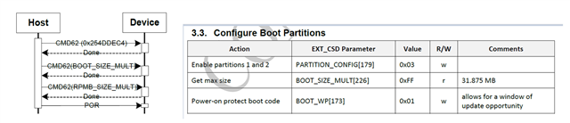

How can I modify driver code or device tree ?  It seems to run CMD62 command.
