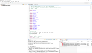

I am using TMS570LC4357 in my project. Now trying to program the micro controller with Code composer studio and facing errors while building the project. I am not sure if any drivers need to be added for this micro controller while downloading the CCS software or is it any thing to do with the imported programming file. Attached the error screen shot . Please help us to resolve the issue
CCS software
File devices/tms570lc43xx.xml does not exist.  Was included by file C:/NMMR_SW2/tools/cs_cba_tool/targetConfigs/TMS570LC43xx_flash.ccxml
File devices/tms570lc43xx.xml does not exist.  Was included by file C:/NMMR_SW2/tools/cs_cba_tool/targetConfigs/TMS570LC43xx_ram.ccxml
This project was created for a device not currently supported - Cortex R.TMS570LC43xx. See 'Help > Check for Updates' to check if support for this device is available through a CCS update.
Visit <a href="liveaction:OpenAppCenter">CCS App Center</a> to get the latest device support. Check if you have installed support for the corresponding MCU/processor platform.
Migrate the project to closest matching supported device by adjusting project properties. Or contact TI for support if using experimental silicon.
used is : Code Composer Studio 8.1.0

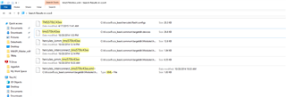

  • Hi Ashwini,
    The xml configuration files should automatically download with CCS and no other softwares should need to be downloaded manually for this device.
    The only thing i am suspecting is
    Did you click on Hercules safety MCU's check box while installing CCS?
    If you click on that box then the xml files of all the hercules devices including TMS570LC4357 should be installed into the ccsv8 directory.
