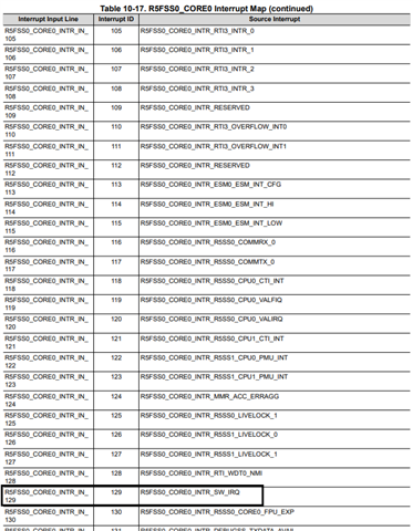

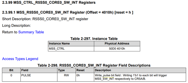

Software interrupt can be triggered by writing a '1' to the respective core's SW_INT Register as shown in the snapshot below:
The VIM needs to be configured with interrupt number 129 from the Table provided in the TRM, highlighted in the snapshot below:

Yes, there is only one explicit software interrupt. However, any of the hardware interrupts can also be programmed through software. For example, the RTI1 interrupt (interrupt number 91) can be triggered by writing 0x08000000 into the VIM_RAW_2 register.

As the interrupt has no source, you don't need to clear the interrupt at source and VIM interrupts are auto-cleared. This is for INT_ID - 129
