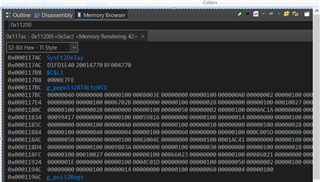

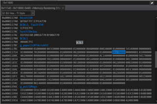

We can see it start at $C$L1, the first one is the one after LM Flasher is done and it's not working after a reset (Fault ISR).
This one is after I programmed it with XDS110 probe and it's working after a reset.
I'm a missing a parameter in armhex or it is a bug with this type of MCU?
I tried many (fill, binary, memwidth=32), none of them have fix it yet.

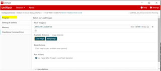

      - Have you tried to use Uniflash to load the same hex file? Uniflash supports both ICDI and XDS110 debug probes and several others. Please see below an example loading a .hex file. Suppose you were trying to load a hex file. Can you repeat the same problem when using Uniflash? The reason is that LM flash programmer can only load the .bin file. If you want to load a hex file, you can use either the CCS or Uniflash. Uniflash is a stand-alone flash programmer tool that supports various debug probes. LM flash programmer only supports ICDI and it can only load .bin file successfully.
      - LM flash programmer does not support XDS110. However, you said using XDS110 works. This means you are using a different flash programmer which is not LM flash programmer. I assume you use either the CCS or Uniflash. Is that correct?

    For the figure, I did load the .out with XDS110, this is how I got the symbol. Then I have downloaded the bin into the flash with LM flash programmer. I restarted the probe with symbol only. This is how I've been able to see the discrepancy between the .out and .bin. And I ensure both .bin and .out where not updated in between.
    I'm using LM flash programmer (build 1613) with a .bin (generated by armhex) not a hex file. Hex file do not seem to be supported. I tried, but the acsii stuff have been written into the flash! I've been using .out for XDS110.
    Yes, but I think the problem is into the .bin itself. Look like a filling issue after a 16-bit variable $C1$L1.
    armhex" --linkerfill --memwidth=32 --romwidth=32 --diag_wrap=off --binary -o "Test.bin"  "Test.out"
      Basically, you are saying the .bin file produces different flash image compared to .out file, correct?

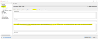

      Can you import the TivaWare hello example at C:\ti\TivaWare_C_Series-2.2.0.295\examples\boards\ek-tm4c1294xl\hello. Look under the CCS Build steps for generating .bin file. See below.   As you can see, it is quite different in the way the .bin file is generated vs yours. I will suggest you use the same steps to generate your .bin file. Give it a try and does it fix the problem?
  • If you build the hello project you would have seen the below commands in the post process step. I'm using CCS10.
    "C:/ti/ccs1011/ccs/utils/tiobj2bin/tiobj2bin" "hello.out" "hello.bin" "C:/ti/ccs1011/ccs/tools/compiler/ti_cgt-arm_18.12.0.LTS/bin/armofd" "C:/ti/ccs1011/ccs/tools/compiler/ti_cgt-arm_18.12.0.LTS/bin/armhex" "C:/ti/ccs1011/ccs/utils/tiobj2bin/mkhex4bin"
  • This is what I'm was looking for. I didn't know where to find it.
    It works well now, and the flash is now the same as the .out.
