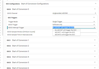

    I think you mean that since I am doing a round-robin SOC for all channels I can only trigger an event when channel 5 (which is last) conversion completes. The transfer triggered by this event could transfer all six CONFIG_ADCx_RESULT_BASE_ADDR.
    Assuming so, I see in the TRM SPRUJ17E - 7.4.2.7 EOC and Interrupt Operation:
    I do not see how to do this through SysConfig.
    How can I enable one transfer for all results in an ADC module?
    Yes. say, SOCx till SOCy needs to be in continuous conv mode, set INT 1 to be triggered by SOCy, and SOC x to y are triggered by INT1. also use the same INT 1 to trigger the DMA channel, where instead of aCnt = 2, it can be aCnt = (y-x+1)*2 if A transfer mode.
    For each SOC in its triggers group, there is a configuration that interrupt can trigger it, [below image for reference]
    Does that make sense?
