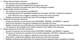

hi, experts:
    We used CCS Theia 1.3.1 to configure and generate code, as known in datasheet, mspm0c1104 has a ADC with up to 10 external channels, but I've no idea how to set the channels in CCS Theia, it seems it could only set one channel. Could you help to show how to get adc results from different channels? All the example codes show only one channel sampling. Thanks.
