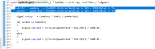

    If you verify capGetSignal function definition:
    As you can see here pwmDuty cycle for capture-0 is capturing from instruction-25 and pwmPeriod for capture-0 is capturing from instruction-26.

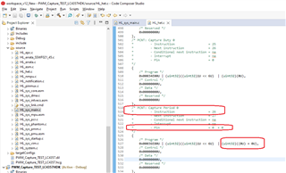

    Now if we verify N2HET code for instruction-25 and instruction-26:
    Instruction-25 (pwmDuty) uses the pin-0 and isntruction-26(pwmPeriod) uses the pin-1. So to measure the period and duty cycle we should use the HR share (this HR share will take the signal from HET pin-0 and supply it to the both the HR internally).
