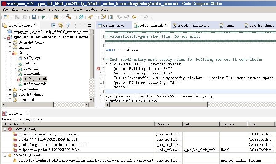

Debug_error subdir_rules.mkDear Experts,
I am new to CCS/TI_MCU.
I was trying to test an example code on the AM243x-LaunchPad demo-board.
I use "open project" to get the example project: gpio_led_blink_am243x-lp_r5fss0-0_nortos.. from AM243x MCU PLUS SDK10.00.00.
I encountered an error after I click debug button.
The CCS error message was captured on the right:
Could you please help to show me how to resolve this error?
Thank you very much.
Best Regards,  JasonC.

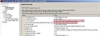

    Also I screen captured some other information here:
    Thank you very much for helping to solve this strange problem.

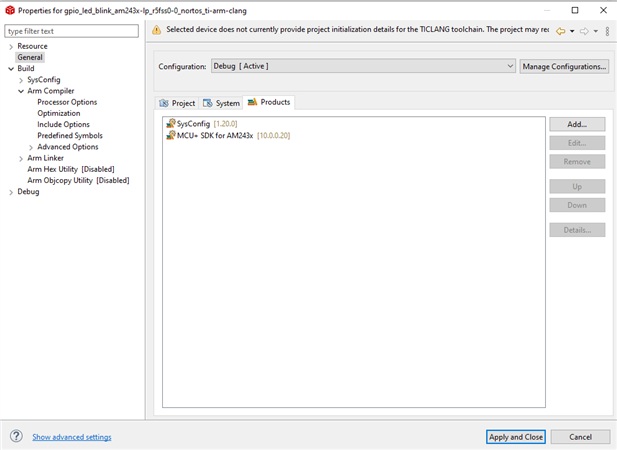

  • Hi Jason,
    Thanks for sharing the above details.
    As I can see you have SDK v10.0 installed but the error logs are coming from SDK v08.06.
    Can you please check the properties of project and share the screenshot?
    To open properties right click on the project. Go to properties.
    Navigate to Properties -> General -> Products as shown below.
    Tushar

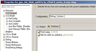

  • Hello Tushar,
    Thank you and you are right.
    I was using SDK V8.06 to report error on the beginning of this question-thread.
    Because you asked me to check. I noticed the SDK was on v8.06, then to-double-check if v10.0 could have similar error, I closed that v8.06 project and imported the same name project in SDK v10.0. I click "Debug" and it still showed error. Till this point, I confirmed the problem was not solved (both version encounter error). After that I did a screen-capture on v10.0 on previous reply to you.
    Here are product list on both SDK cases:

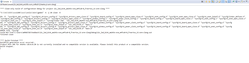

    I noticed that the Consol message for "build-all" error on SDK v10 is different from that of SDK v8.6.
    I copy the SDK v10 Consol content here:
