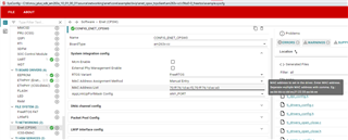

  • Also, can you provide a way to customize the mac address in the demo, using an array in ram to store the mac address.
  • Hi P Zy,
    The demo has not been removed from the SDK 10.01 version, rather it has been moved to a new path. The example "enet_cpsw_tcpserver" is present at: "mcu_plus_sdk_am263x_10_01_00_31\source\networking\enet\core\examples\lwip\enet_cpsw_tcpserver"
    Shaunak
  • For the MAC address allocation, by default the example uses the MAC addresses stored in the device EEPROM. Incase you want to switch to manual assignment of MAC address, in the Syscfg-GUI you can go to Enet (CPSW) -> System integration config. Here you can switch to MAC address assignment mode as Manual Entry and enter the desired MAC address.
    The MAC addresses will be stored in an array in the .text section which is in OCRAM. The auto-generated code for this logic is in the "generated/ti_enet_config.c" file.
