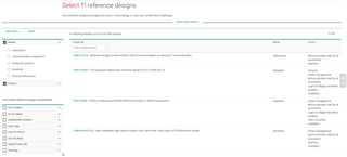

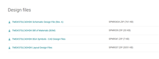

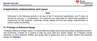

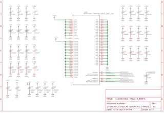

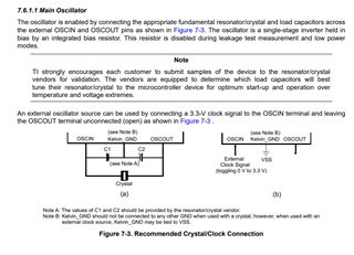

The application notes and layout guidelines for the TMS570LC4357-SEP do not appear to be included in its datasheet. While a link to TI Designs is provided, it does not contain any reference designs specific to this MCU. Could you please share any available application notes, reference designs, or documentation relevant to the TMS570LC4357-SEP?

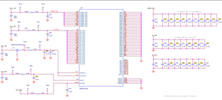

3. Could you let me know which pins can I use to monitor PWM input?

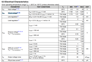

4. I am planning to use the TPS73801-SEP LDO set to 3.3V as both the ADC reference voltage and VCCAD. However, I have some concerns regarding the variation in Vfb and Ifb over temperature.
Based on the datasheet, considering a Vfb variation of 1.21 V ± 0.035 V, my calculations suggest that Vout could vary by as much as 3.3±0.1 V. However, the load regulation curve indicates only about a 7 mV variation under typical conditions. This discrepancy is a bit confusing.
Since I intend to use this LDO as both the reference voltage and the supply for an NTC voltage divider circuit, and all ADC channels will be used solely for monitoring temperature from these NTCs, I’m concerned that this potential voltage drift might introduce significant errors in the temperature measurements.
Could you please clarify the expected variation in Vout over temperature in this application, and whether this approach is viable for accurate temperature sensing?
