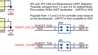

I am using the MSP-EXP432E401Y development board.
I modified the line UARTStdioConfig(0, 115200, g_ui32SysClock) in the enet_lwip.c file of the ethernet_with_lwip_MSP-EXP432E401Y code example.
Instead of passing 0, I used 2 to access UART2 of the microcontroller.
I also removed jumpers JP4 and JP5 to disconnect UART from the debugger, and connected a COM port directly to the UART2 pins (TX, RX, and GND).
However, when I run the code, the terminal does not display any output from the UARTprintf function.
For example, the line UARTprintf("Ethernet lwIP example\n\n"); does not print anything.
When I perform the same procedure using UART0 (as in the original example), the output appears correctly on the terminal.
Is there anything else I need to do to access UART2?
    You don't just remove JP4 and JP5 but rather change from their default vertical orientation to horizontal orientation. Once you do that, the UART2TX and UART2RX are routed to the XDS110 debug probe for COM port. Refer to the user's guide for details.
    2.1.6.2 BoosterPack Plug-in Module Interface 2
    The second BoosterPack XL interface is located near the bottom of the board. This interface is fully compliant with the BoosterPack plug-in module standard, and adds features not covered by the BoosterPack plug-in module standard that enable operation with additional BoosterPack plug-in modules. Using the jumpers JP4 and JP5, Controller Area Network (CAN) digital receive and transmit signals can be optionally routed to the BoosterPack Plug-in Module Interface 2 connector. In the default configuration, UART0 is used for the XDS-110 backchannel UART and CAN is not present on the BoosterPack plug-in module headers. In this configuration, the ROM serial bootloader can be used over the XDS-110 backchannel UART. When the jumpers are configured for CAN on the BoosterPack plug-in module interface, then UART2 must be used for the XDS-110 backchannel UART.

  • After programing  i removed JP5 and JP4 jumpers  of MCU to avoid access of UART through debugger.
    Normally, you would change the JP4/JP5 from their vertical orientation to horizontal orientation so that UART2 is routed to the integrated XDS110 on the LaunchPad. There is no need to use a separate FTDI chip from UART2 to your PC. If you want to use your own FTDI for UART2 then you need to put back the JP4 and JP4 to their vertical position. In this case, the UART0 is still connected to XDS110.

    I tried to access UART2 through XDS110  by changing the JP4/JP5 from their vertical orientation to horizontal orientation . Still I  am not able to get prints on putty terminal. Is there any other parameter in code i need to change . Till know i have modified the line UARTStdioConfig(0, 115200, g_ui32SysClock) in the enet_lwip.c file of the ethernet_with_lwip_MSP-EXP432E401Y code example to UARTStdioConfig(2, 115200, g_ui32SysClock).
  • Below is what you have in your code. The problem is that in PinoutSet() it only configures UART0, not UART2. You would need to change it for UART2.
    // Configure the device pins.
    PinoutSet(true, false);
    // Configure UART.
    UARTStdioConfig(2, 115200, g_ui32SysClock);
    Why don't you write like below to configure UART2 before you call UARTStdioConfig(2, 115200, g_ui32SysClock).
    SysCtlPeripheralEnable(SYSCTL_PERIPH_GPIOD);
    SysCtlPeripheralEnable(SYSCTL_PERIPH_UART2);
    GPIOPinConfigure(GPIO_PD4_U2RX);
    GPIOPinConfigure(GPIO_PD5_U2TX);
    GPIOPinTypeUART(GPIO_PORTD_BASE, GPIO_PIN_4 | GPIO_PIN_5);

    Hi Sir,
    After adding above written lines in code , I am able to access UART2.
    Right now at a particular time I am able to access either UART0 or UART2 depending on what parameter i enter in line UARTStdioConfig(2, 115200, g_ui32SysClock) at the end .
    My question is what changes i need to do to access both UART simultaneously . Do I need to set parameter in line UARTStdioConfig(2 or 0, 115200, g_ui32SysClock) each time I send data.
    For example I want to transmit two different types of data through UART0 and UART2 simultaneously .
  • My question is what changes i need to do to access both UART simultaneously . Do I need to set parameter in line UARTStdioConfig(2 or 0, 115200, g_ui32SysClock) each time I send data.
    If you want to use the integrated XDS110 debug probe on the LaunchPad as a USB to Serial converter then you can only use either UART0 or UART2 one at a time. Refer to the LaunchPad schematic. See below. The TARGET_RXD and TARGET_TXD go to the XDS110. The JP4 and JP5 acts as multiplexers to select either PA0 and PA1 for UART0 or PD4 and PD5 for UART2. If you want to use both UART0 and UART2 at the same time then you can use UARTStdioConfig for UART0 and then duplicate the UARTStdioConfig function such as UARTStdioConfig2. For UART2, you need to externally use a FTDI USB to Serial converter. You can also use the UART API to send/receive to any UART instance. Use the C:\ti\simplelink_msp432e4_sdk_4_20_00_12\examples\nortos\MSP_EXP432E401Y\driverlib\uart_echo to see how to send/receive to the UART.
