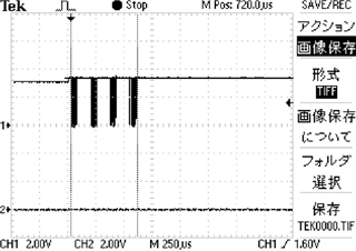

    At OSPI boot, only DQ0 and DQ1 signals are working for ~720usec.
    DQ2 to DQ7 signals are kept High.
    This is DQ0 signal waveform.
    On control card, all DQ0 to DQ7 signals are toggling.
    (no waveform is taken)

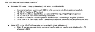

    I got one update from the customer.
    The device customer uses is default Extended SPI(1S-xy-xy) mode. Please see page#95 of the datasheet.
    https://www.issi.com/WW/pdf/25LX-WX256-128.pdf
    In this case, AM263P4 boot mode also needs to be OSPI(1S) - Single Read Mode, correct?
    They are currently using OSPI(8S) - Octal Read Mode.
    TRM table 5-2:
    Thanks and regards,
    Koichiro Tashiro
  • n this case, AM263P4 boot mode also needs to be OSPI(1S) - Single Read Mode, correct?
    The terminology OSPI(1s) - 1s stands for data lines.
    Where as in flash datasheet I see below description:
    Could you please ask customer to try with 1s-1s-1s first then move to 1s-1s-8s then to 8d 8d 8d
    This can be done with ospi_flash_io_example as well, they can see if read and writes are working properly or not.
