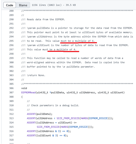

TM4C129XNCZAD: The memory structure of the incoming mailbox needs to be aligned.
Part Number: TM4C129XNCZAD
Hi:
I leave this message here, so that those who are lucky enough to see it, can avoid this pit!
We spent a lot of time searching for the cause, and finally realized that the size of the memory structure brought into the mailbox was a multiple of four.
The modified code was installed on 5 devices, and they ran without shutting down for 90 days without crashing.
