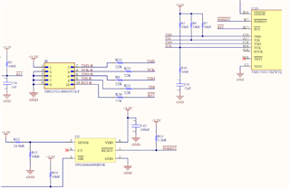

I have a problem debugging a TMS570LC43.
It is on a custom board. The debug connections are shown in the figure.
It uses a Cortex 10-pin debug connector. A XDS110 is used with the corresponding adapter.

What is going wrong?
I am wondering about the line:
"The scan-path will be reset by toggling the JTAG TRST signal."
As TRST is not used. According to ARM there is an alternative way to reset, what do I have to change to get that work without TRST signal?
