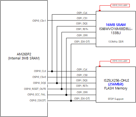

I'm planning to use the OSPI interface of the AM263P2 MCU as follows:
1. We plan to use the 16MB SRAM from ISSI for data logging via the OSPI interface CS1. (I understand this connection is slower than the SRAM inside the AM263P2, so I plan to use it for data reference purposes.)
- 133MB DDR CLK
- 3.3V power supply

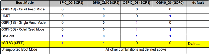

2. We plan to use the 256Mbit flash memory from ISSI, which supports SFDP (Serial Flash Discoverable Parameters), via the OSPI interface CS0 for OS booting.
- MCU boot mode will be xSPI 8D (SFDP).
- 133MB DDR
- 3.3V power supply
3. We will use the OSPI signals in common, but use a separate chip select.
Question
1. Are there any issues with the circuit diagram?
2. Is there a problem with operating two components (SRAM and FLASH) simultaneously?
  • Hi Jongho Park,
    Apologies for the long delay!!
    ISSI PSRAM cannot be used with AM263Px OSPI0 interface as it requires additional Address Translation logic. Instead you can use a APMemory PSRAM which doesn't require address translation.
    Can you please elaborate on the use case ? Since there are no separate configuration registers for 2 Chip Selects, SW needs to takecare of switching the configurations for PSRAM and FLASH which is quite tricky. And the program during the switching should be executed form RAM instead of Flash (as controller will be busy configuring the PSRAM).
    Hence in summary simultaneous operation is not supported
    Instead I would like to pitch you another device from the same family --> AM2612
    AM2612 is a dual core device which has 2 separate OSPI Controllers(OSPI0 \ OSPI1):
    1. OSPI0 - CS0 can be connected to ISSI FLASH for boot
    2. OSPI1 - CS0  can be connected to ISSI PSRAM. OSPI1 interface in Am2612 has additional Address translational logic extending its support to ISSI PSRAMs
    Please refer to section 13.3.5 Octal Serial Peripheral Interface (OSPI1) in Am261x TRM for more details.

  • Hi Jongho,
    After thorough examination of your requirements, I would like to provide the following clarification:
    Technical Limitations:
    The OSPI interface on the AM263P2 utilizes a shared address and data bus architecture with device selection managed through individual Chip Select (CS) signals. Due to this hardware design constraint: Simultaneous operation of multiple devices (Flash and pSRAM) is not feasible through a single OSPI controller.
    Implementation Approach:
    While simultaneous operation is not possible, you can implement a sequential access methodology with the following considerations:
    1. Controller Configuration Management:
    • Each memory device type requires specific controller configuration parameters.
    • Flash memory operations utilize distinct command sets and timing requirements.
    • pSRAM operations necessitate different protocol configurations and access patterns.
    2. Runtime Switching Protocol:
                     When transitioning between Flash (CS0) and pSRAM (CS1), the application must:
    • Save current context if necessary.
    • Reconfigure the OSPI controller with appropriate parameters for the target device.
    • Execute the required memory operations.
    • Restore previous configuration if returning to the original device.
    Clarification of Previous E2E Response:
    Regarding the statement from the E2E forum: "They can use it at runtime as well, if they can do proper handling at the application level."
     This specifically refers to the requirement for implementing the aforementioned controller reconfiguration logic within your application. The "proper handling" entails managing the configuration transitions between devices during runtime operation to ensure correct protocol parameters are applied before accessing each respective memory device.
    Let me know if you need more clarification on this.
