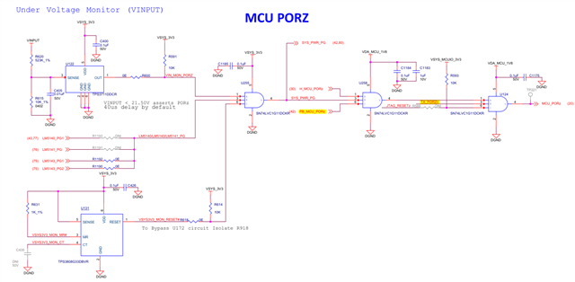

please help to review the following reset topology for TDA4VH-Q1 chip:
Gavin
The diagram shown is similar to the TDA4VH EVM SCH (PROC141E5_SCH) available on TI website. The diagram does not show the EVM's additional Push Button (PB_MCU_PORz), TI Automation (TA_PORz) or PCIe0/1_PORz paths for resetting the SoC as shown below.
SCH pg 43:
SCH pg 43:
