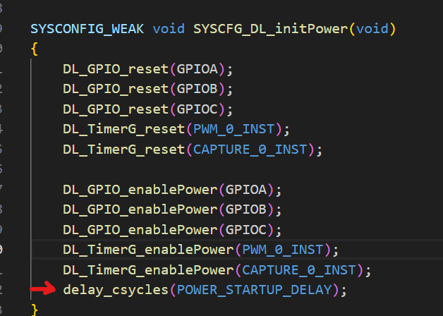

Dear TI Expert,
From the SDK examples, I noticed that delay cycles are often inserted immediately after enabling a peripheral.
Is this delay actually mandatory before configuring the peripheral registers?
In our system architecture, each peripheral has its own module responsible for initialization. If we introduce a delay in every module, the total initialization time will increase significantly.
If the delay is not strictly required for correct operation, we would prefer to remove it.
Please advise.
